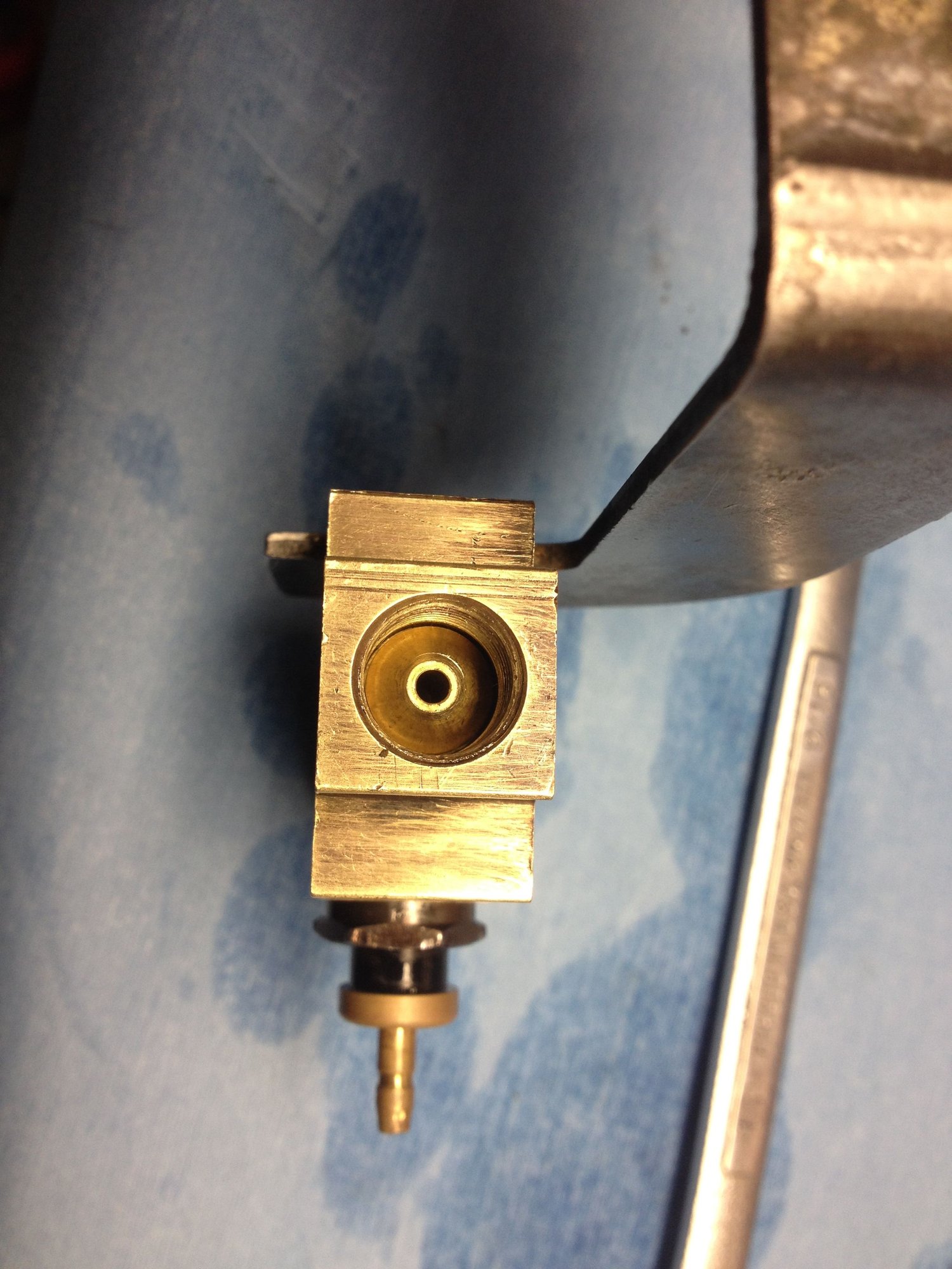

Got my rebuild kit
cleaned up with new orings
new seats
lots of q=tips

https://www.musclecarresearch.com/gm-3956727-autopsy
It's a great site with some cool stuff. Paid under 13 bucks
