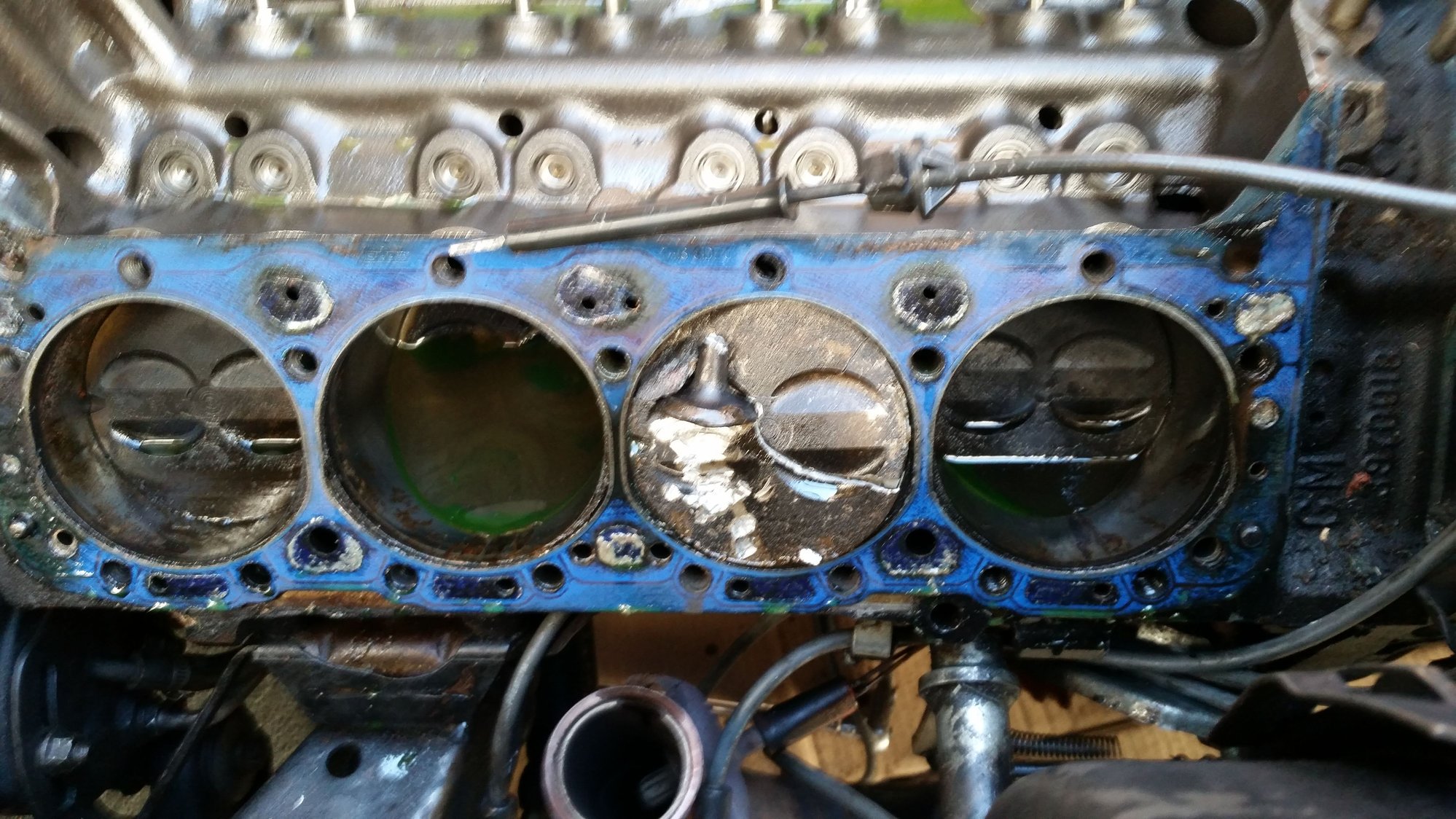

Hey guys really sorry about the crazy late response law school has been keeping me extra busy.
So I found out where the clacking was coming from! Yayyyy... Well actually the car told me, as the engine blew up while I was going 60 on the highway lol. I got verryyyyy lucky and managed to coast to the exit and pull over. After getting the car home I started taking it apart to look for what went wrong and after pulling the driver side head off I found something very interesting.... The clacking? That was the valve hitting against the head due to a bad valve seat, until the point that it broke off of its stem, fell down into the combustion chamber, cracked the piston, and in turn, cracked the block. The block is now a coffee table at my cousin's house.
Thankfully I found a used 350 a few hours away from me for cheap out of an 85 k20. put the block and heads from it in with the corvette's everything else. It's been running fine except for a strange coolant leak.
Just want to warn anyone out there who experiences something like this...check the valve seats!!!
If you look closely, one does not look like the others.

Glad you got it fixed, but this was your clue that the valve needed to be changed / head removed. "heres the thing...i noticed while replacing the rocker arm that the valve tip was a little banged up and convex in shape. the rocker arm also showed signs of wear and was concave in shape...seemed like the valve tip sat lower than the spring retainer and was causing contact problems...new one doesn't show any wear yet..."
Seems like the rocker eventually pushed on the retainer and let the keepers out, valve dropped into the cylinder.

Thanks man but here's the funny part... the rest of the valve (the stem) was still attached to the spring and held up by the retainers.. but you're right I definitely should have replaced the heads before this happened

I read this thread for first time today. My first thought was bad/worn guides and/or valve seats. I had similar behavior but with all of the exhaust valves. After 40k miles, the hardened seats (DART iron heads) wore out and then the guides followed. I had noisy valve train that would quiet down when I dropped it into OD... anything over 1,500rpm and I had valve clatter. Tried replacing rockers, pushrods, setting/re-setting valve lash and no improvement. Even suspected worn cam lobe(s). Solution was a full set of bronze guides and ductile iron valve seat inserts. I'm glad I got this taken care of before I dropped a few valves. I had this done back in 2013 at the time I had shop install new springs, keepers, locks and seals for the retro-roller kit. Very quiet now. Went with Comp Ultra Pro Magnum roller rockers at the same time.
What surprised me was the fact the noise started at time he replaced the valve seals; unless something 'gave out' during that procedure (such as cracked rocker as others had suggested) or perhaps with the stress removed from the valve at time that the locks were removed/installed, it didn't seat the same and wore even faster.
However, when he mentioned the valve tip was hammered and rocker looked same, I thought the valve had to be wiggling in its bore. Sorry to hear it dropped and ruined the engine.
