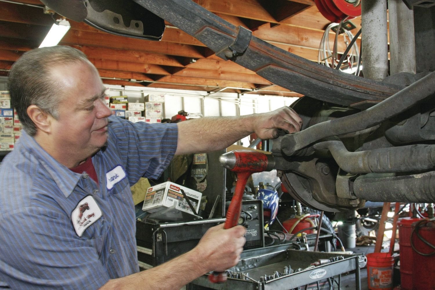

Originally Posted by kanvasman
If you are going to beat it to death, unscrew the nut until it's even with the top of the tie rod, that way the hammer won't damage the threads.
You don't hit the tie rod. You hit the knuckle that the tie rod is in. It'll pop right out.
See where this guy is hitting it.
NOT ALWAYS...sometimes they do not like to 'just pop out'.....and try doing that on C4 suspension which is aluminum and see what happens.
They make special tools for this...OR... smack and beat away if you must.
And with this type of removal process being discussed. I would love to see the condition of the gear box after someone beat the pitman arm in order to remove the same type of taper seated stud on the center link or the power steering control valve.
Then you're doing it wrong.
We're not talking about C4's.
Again, if you damage anything, you're doing it wrong.
Trust me...I know how to do it. And they do not always fall out like you mentioned. YOU must have the 'touch'. Honestly..I am glad I do not have THAT touch.
I know that...BUT...if tools are made to not damage the aluminum suspensions....why would you want to whack on any other suspension parts. REALLY...Like the time being spent is so valuable that the few moments of difference in time means that much....if that is what this whole discussion is all about....TIME
I do not damage a thing....I guess it is because I use the proper tools for the job...and not just swing a dead blow hammer around. Not writing that I have not used the 'hammer method' successfully...but my methods have changed due to working on many Corvettes that suspension parts are really nice and I feel better not hitting them and marking them up. I am just being conscientious about the condition of my customers Corvettes when they are services and returned to them. Damaging powder coating and paint finishes is NOT something I want on my resume.
Much like using an impact on chrome jug nuts...which I never do.....instead of hand loosening/tightening them and using a torque wrench. It all depends on the level of care and attention to detail that a mechanic employs.
