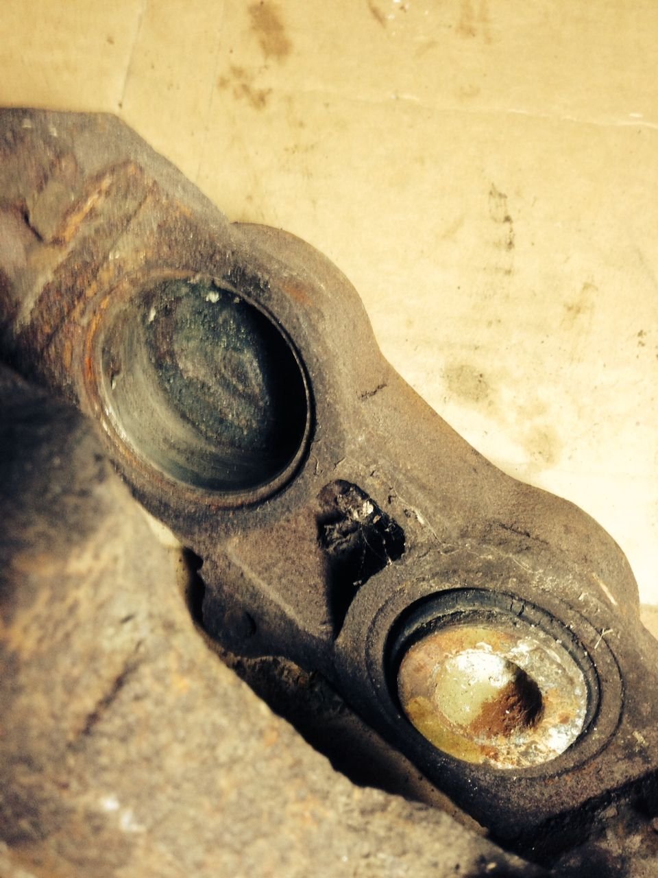

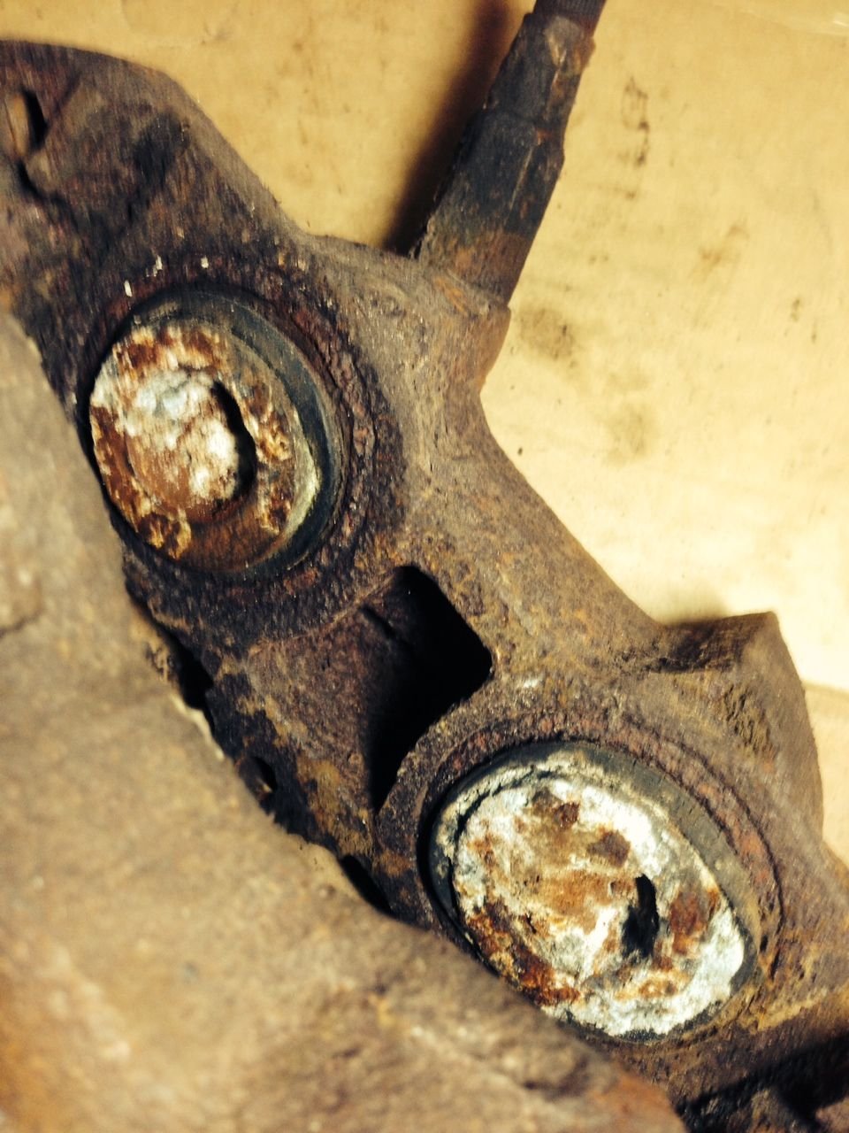

These are my new Remanufactured Advance Auto calipers. They are Delco Moraine and cost $42.50 each with a lifetime warranty. I couldn't rebuild my old ones for that.....The pistons were corroded and the bores were pitted. Not sure if they were even SS sleeved. The core charge was 45.00 each. Should I keep the old calipers or just return them for 45 bucks? The car is 1970 coupe with original 350/300 engine, M21 trans and 4.11 rear.

you could use them as door stops or paper hold downs. I still kept my originals don't know why they weren't that bad maybe im hoping to run in to a guy with a 69/70 impala who wants to convert to disk brakes and help him out but they are just chilling in a box

Wow those are really bad... I would try to use them as cores.... they are no good really even as rebuild able cores so they may no accept them.... funny how advances prices are so much cheaper for you? Advance now sells "new" calipers for our cars too....sold under the weaver name I believe... they were still under $100.... likely the same china one I got. Funny thing is mine does not say made in china anywhere on the unit or box?

what makes them "no good as cores"? a trip to the sand blaster, some SS sleeves, new pistons, seals, some silver paint and they will look just like yours...

Well from other threads I've read here about caliper core credit being rejected a lot of these rebuild companies are pretty picky on core condition and the amount of surface removal and possible blockage of the fluid passages makes a lot more work involved in refurbing those.
Those look like they were sitting in the dirt for a while and even after blasting the surface will be pretty pitted. Not something I would pass on to another corvette owner..

that the factory never used o rings, they should have. I've found most of the good rebuild kits have aluminum pistons with some type of corosion protection. those cast iron calipers can corrode a lot before they are unusable. im waiting for the chinese to start casting them in aluminum, wouldn't that be nice ! im not holding my breath though.

Advance would not even look in the box before refunding the core. Believe it or not the rears looked just as bad as these. A few minutes on the wire wheel and I had them looking like brand new except the bores where still pitted even after trying to clean them up with my die grinder and fine medium grit sandpaper wheel. The online price for them is 64.99 but Advance has been running a special of 15% off and a 25.00 gift card good on your next purchase so it works out to be around 45 bucks each....can't beat that for and they are guaranteed for life!! I don't think I would like the Chinese calipers. The only reason I went this route was the fact that they were Delco castings and look original. As mentioned earlier...does it make sense to keep the cores as I have a numbers matching car??
