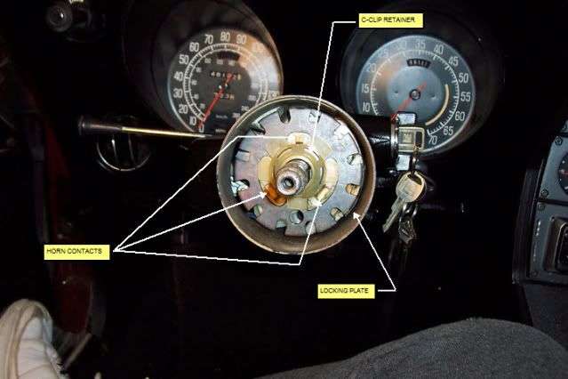

OK so you will need to take apart the upper part of the steering column to accomplish this task…unless I am just lost here which happens lol. Take off the horn stuff and the steering wheel..under that you will see a black flat plate with notches around the outside. That is where the pin slides into what turns to lock the wheel. You need to either trim back the pin that locks into that plate or remove the pin entirely. I cannot remember how far the pin fits up into the housing that it is sliding through so you can try just trimming it back so that it will not lock into the plate and see what happens. Sorry but it has been about ten years since I rebuilt one lol. I would think someone here could provide pics for you….I will do some looking on the internet and see if I can find one.

The flat black plate is the locking plate…there is a pin that slides into it about 2 o'clock that moves with the key position and is spring loaded. Either trim back that pic or remove it to make is so that you can turn the wheel when the key is removed.

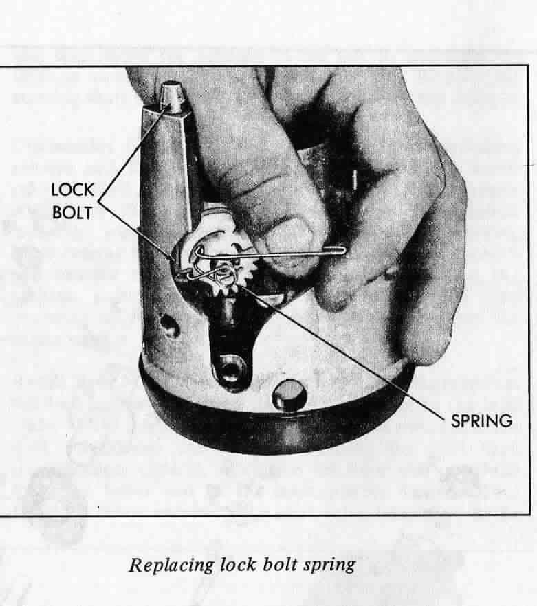

Basically, you want to disassemble the steering column head to the point where you can remove the "grasshopper" spring and then remove the locking bolt.
Here are a series of papers that will walk you to the point where you can reach the spring, sector, and locking bolt. You probably don't have to remove the steering column from the car since you should be able to pull the turn signal switch out of the column head far enough to pull the turn signal switch housing and reach the locking bolt.
Here are links to three papers and three pages of pics to assist you.

I am trying to find out the many functions of the "grasshopper" spring shown above. One end of the spring definately is attached to the locking bolt. That end is useless if there is no bolt in place.
The other end of the spring is attached to the housing with a screw. That end needs to be retained along with the screw. Now the center portion of the spring reaches into the plastic sector. I assume it preloads the sector so that it doesn't feel loose as the sector attaches to the lock cylinder and engages the teeth on the die cast rack.
Maybe you should cutoff the end of the spring that should attaches to the locking bolt. You certainly don't want that loose end flopping around. However, you also don't want the spring "walking" out of the sector. You will just have to cut and try things. That multifunction spring was there for a couple reasons and I just am not that familiar with the design when you eliminate the locking bolt.
