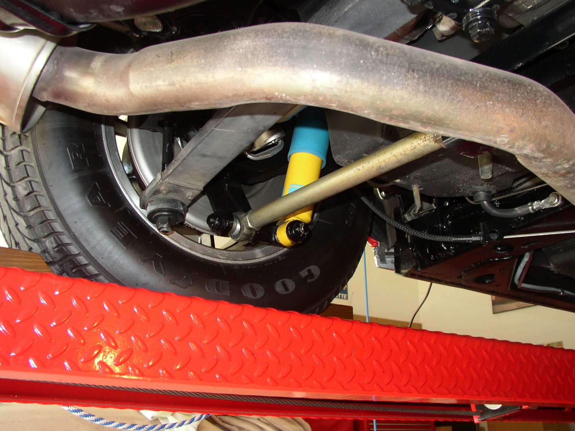

Originally Posted by PeteL46
Originally Posted by GUSTO14
I have Bilsteins on four different Corvettes and two pickups and have been very pleased with them. I prefer the Heavy Duty's on my Corvettes just because I like the firmer ride. I also autocross and feel that the Bilsteins represent one of the best values in improving the handling of an otherwise stock Corvette.
These have been on for over 15 years and still perform superbly.
Good luck... GUSTO
Don't mean to hijack . . quick question . .
Are those VR Gatorback's? What size? How old are they?
Yes, they are Gatorbacks. 255/60-VR15's, the picture is a few years old. Had them on all 4 corners for years. Finally had to replace the front ones with 225/60-VR15's. Been considering these for a while now as a replacement...
http://www.kelseytire.com/pages/larg...GT-Radial.html
Good luck... GUSTO
