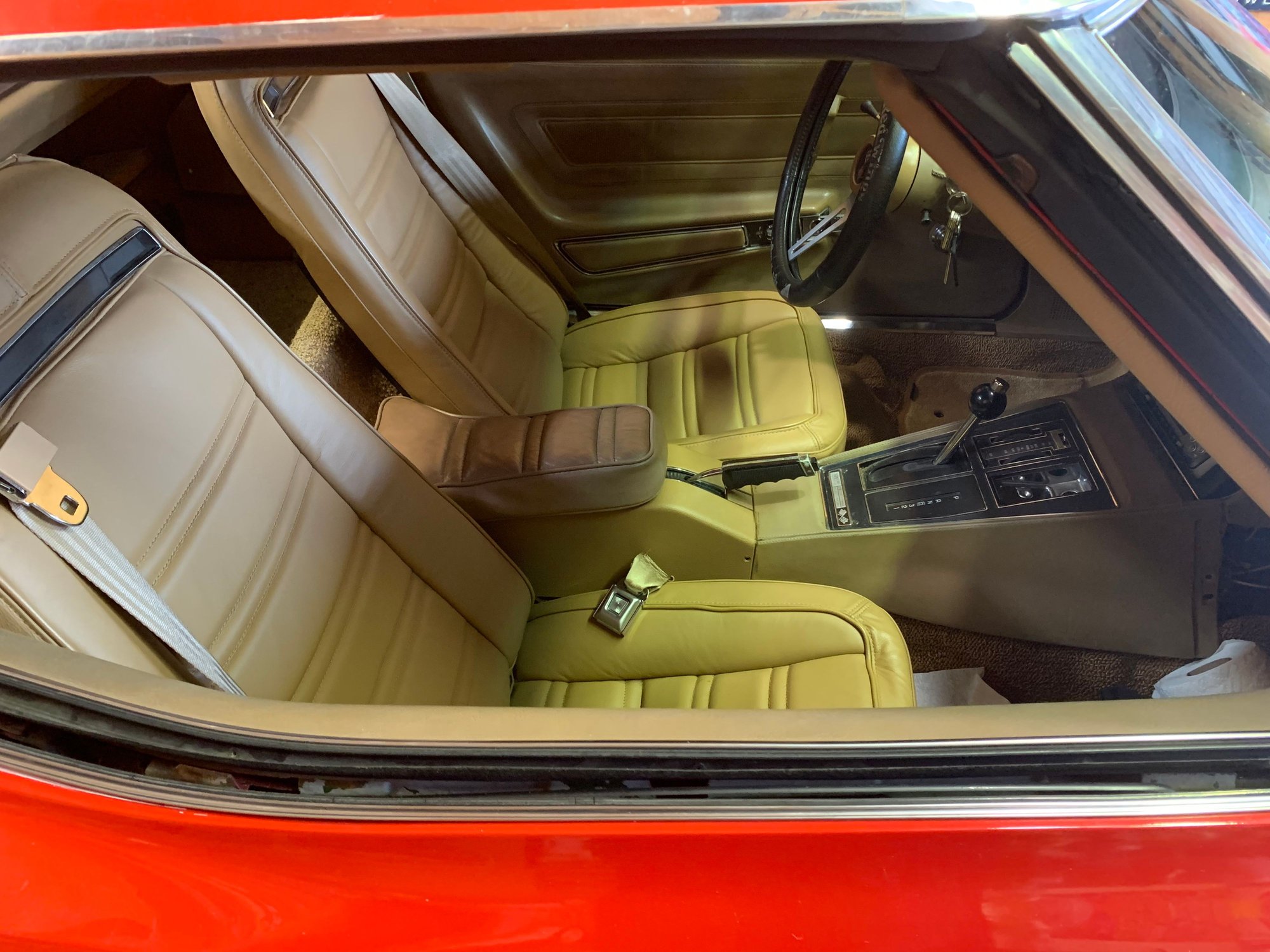

Old Nov 19, 2022 | 11:02 AM
laz749's Avatar
laz749
Joined: Jan 2013
Posts: 194
Likes: 86
From: Arkansas
No mods to the car, 6 bolts and back to stock.

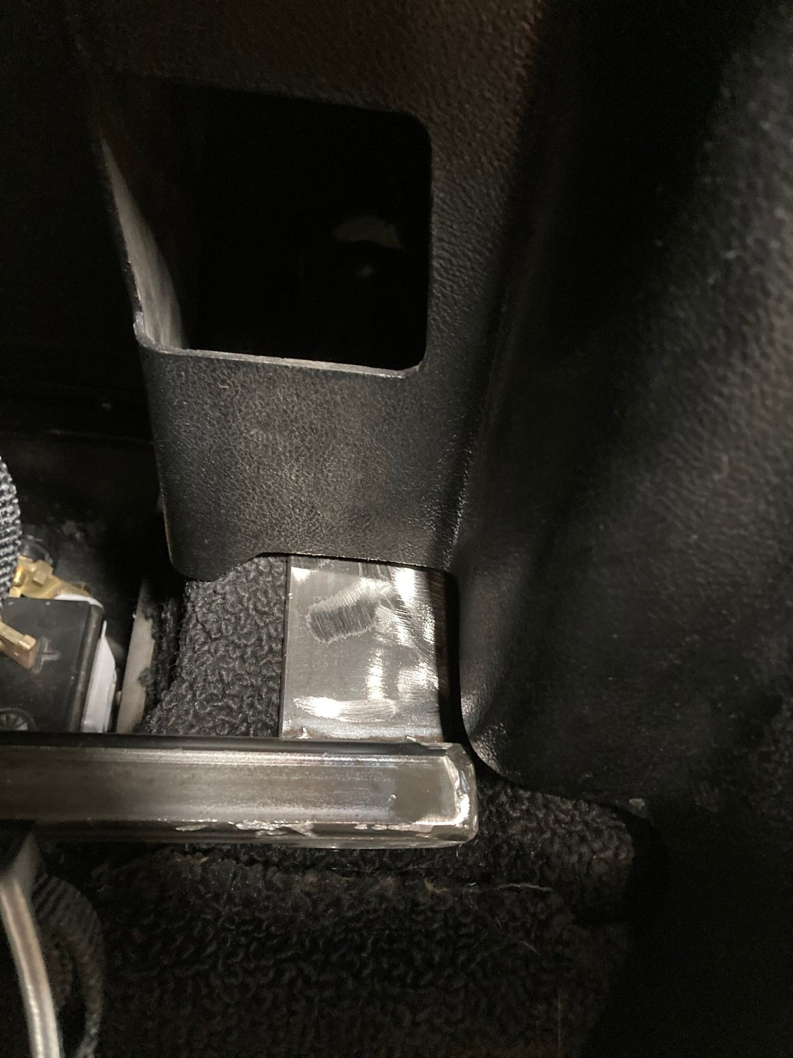

I’d really like to add 3 point belts to my 72 convertible but of course the seats don’t have the pass-through. I don’t love the idea of guides on the sides of the seats. Does anyone make a kit to cut out and clean up the slot, or do I have to get new seat backs?
There's an internal piece that need to be added to the seat to guide the belt through the slot and then a metal trim piece where it exits the rear of the seat. The front part that you see has the windows popped out of where the belt goes through. As far was I've ever figured out, they all were made with both holes blocked off and then they popped open the side (drivers or passenger) when then needed them to be used for cars with shoulder belts.

To get the belt through the seat you need to remove the buckle.
Pull out the retainer bar by slightly spreading the sides apart. They are very stiff so you cannot break them. It helps to have an extra hand to put them back on but i did it by myself
To get the mounting plate through the back of the seat I had to remove the back trim plate off the seat. String the belt through the trim plate and then through the seat. once the belt is through the seat you can put the trim plate back on.

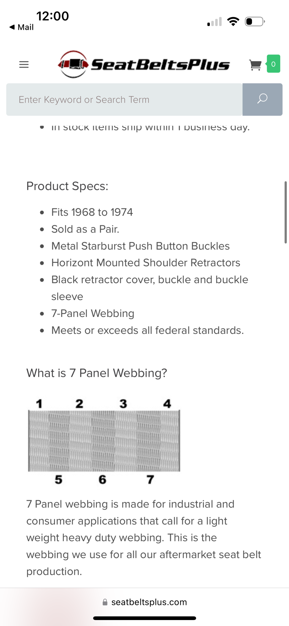

hi redwingvette, thank you for the photos, I love the look and am looking to do the same retrofit with some electric blue webbing for my 73 coupe
The link you sent above seem to be landing on a chrome lift latch universal seatbelt but the photos show a standard buckle. Are the photos from the firebird retrofit you had prior?

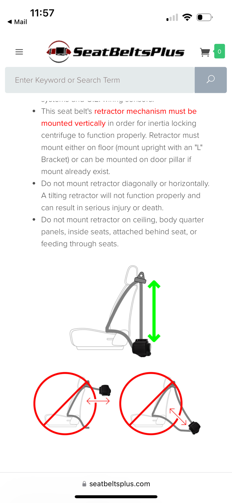

Thanks, I think this would be the link then
https://www.seatbeltsplus.com/product/6874MB.html
Looking at it again, even though there is a notice that it shouldn’t be mounted horizontally, it might actually not be applicable to this specific one. Second screenshot does highlight horizontal mount.
