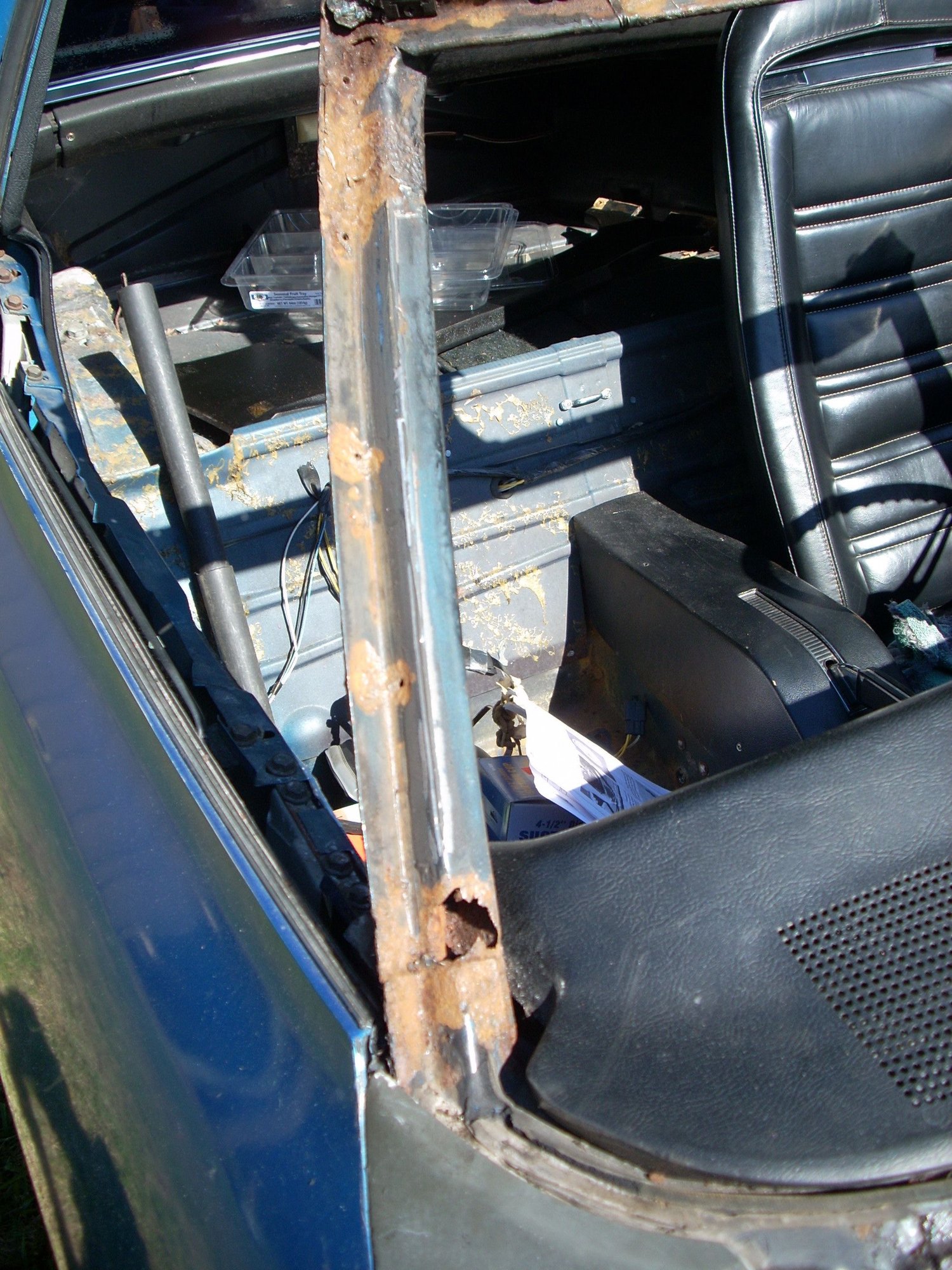

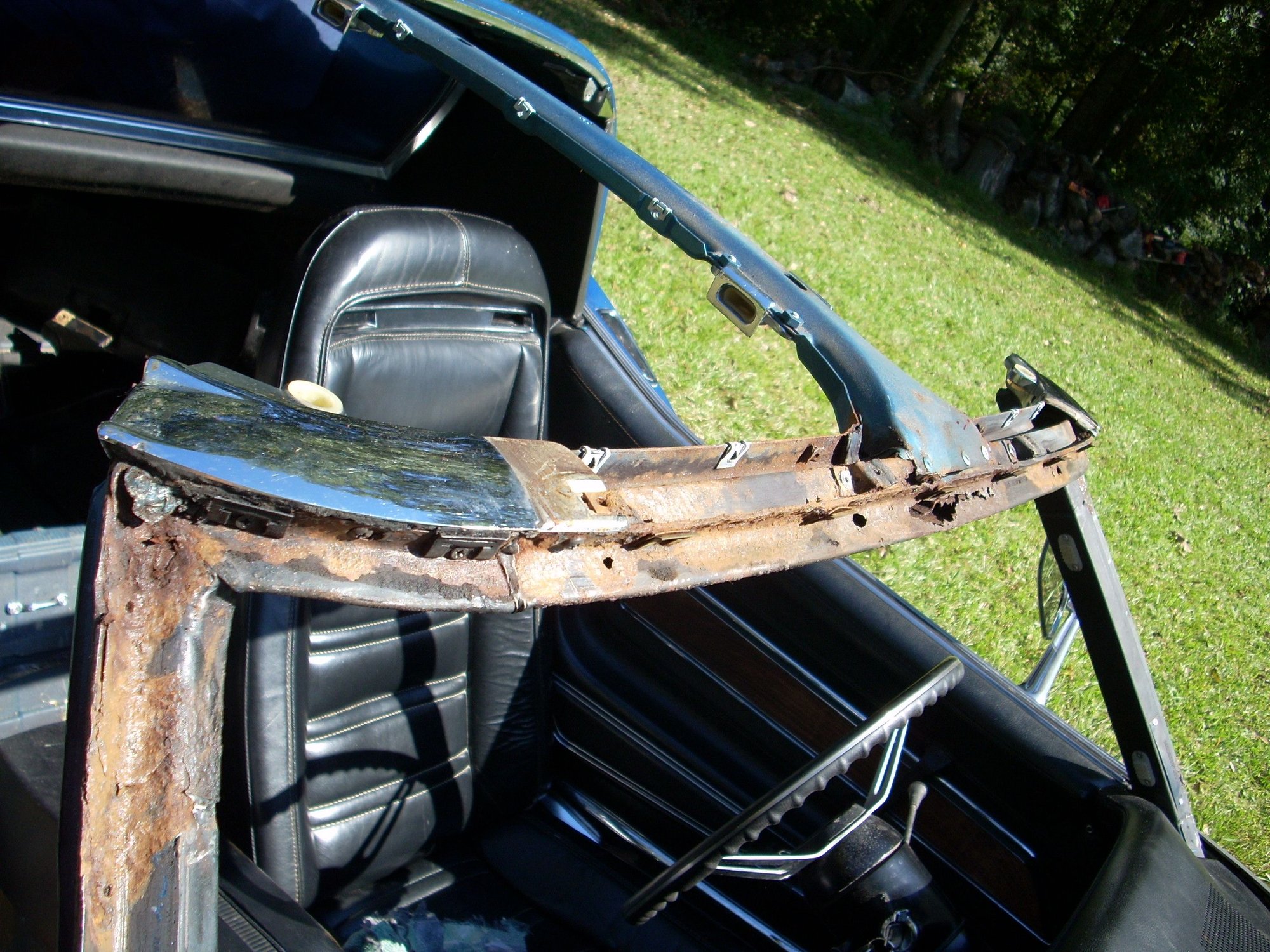

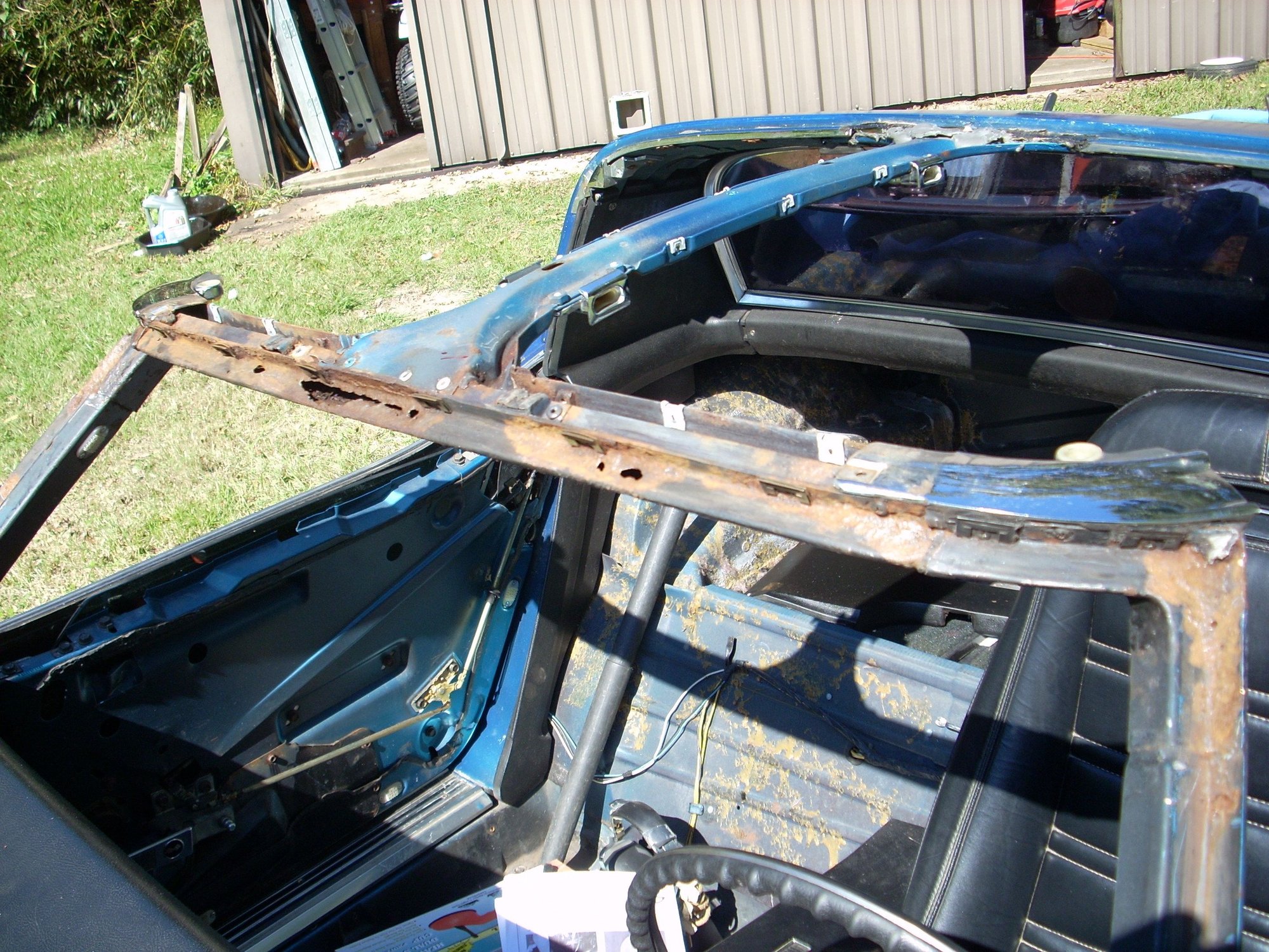

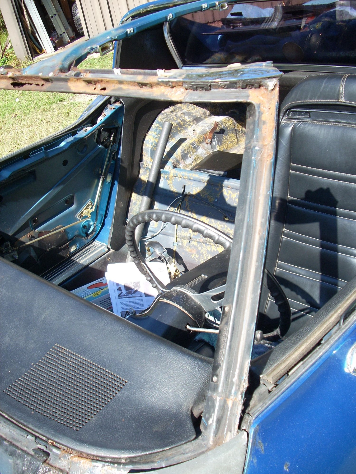

Default ok photos are always a challenge for me.
Ok photos are always a challenge for me.
Here we go, see if this works.
Also thanks for the advice to treat rust first, that makes a lot of sense!

Looks like u have the easy stuff uncovered. Any decent body shop can weld in replacement patches for that exposed stuff. Thats as easy as it gets for them.
U really need to open the body mount inspection covers behind the floor vents and the rear wheel wells in front of the rear tires. This is where water runs down to and collects around the body mounts. The vendors sell the mount plates that run under the door sills and connect the birdcage front and rear. U will have to lift the body to replace those plates though.
Yes 16 gauge is 1/16" thick steel.

Yep, I think I got off fairly good on the windshield frame, back side all good. Interesting to me is a lot of C3's have some damage behind the windshield that owners do not know about and you won't know until you take the windshield out. Case in point, I could see the passenger side vertical front pillar rust hole before I opened it up and I thought that was the only place, oh well, better to get it all fixed now!
And yes already checked behind the kick panels and elsewhere and it is very good.
Thanks!

Thanks for the photo's.
If you want my opinion. And I hope you know this is what I do for a living, IF your car were in my shop. I would NOT patch in any metal along the top. It needs a new piece of frame. The top right corner gusset...it needs to be replaced also. PERIOD! A pain in the backside...YES...but it is... WHAT IT IS. Obviously the choice is yours. There is so much rust on the inside of the top frame section...it would be a total waste of time to try to save it....especially with the fact that they are available.
On the right pillar post...where the hole is at the joint. Knowing that you can get the inner and outer pillar post metal pieces...I would cut out the outer one ...clean up the inner one so all rust is gone...then weld in a new piece.
This windshield frame is NO WHERE as bad as some that I have had in my shop. And I am aware that there are 'other ways' of fixing this. The 'trick' is finding a way that actually fixes it and not just doing a 'patch job' on it....unless you can live with it being like that...and it possible coming back on you again. That is why my way of thinking makes it so I do not have to do it twice.
