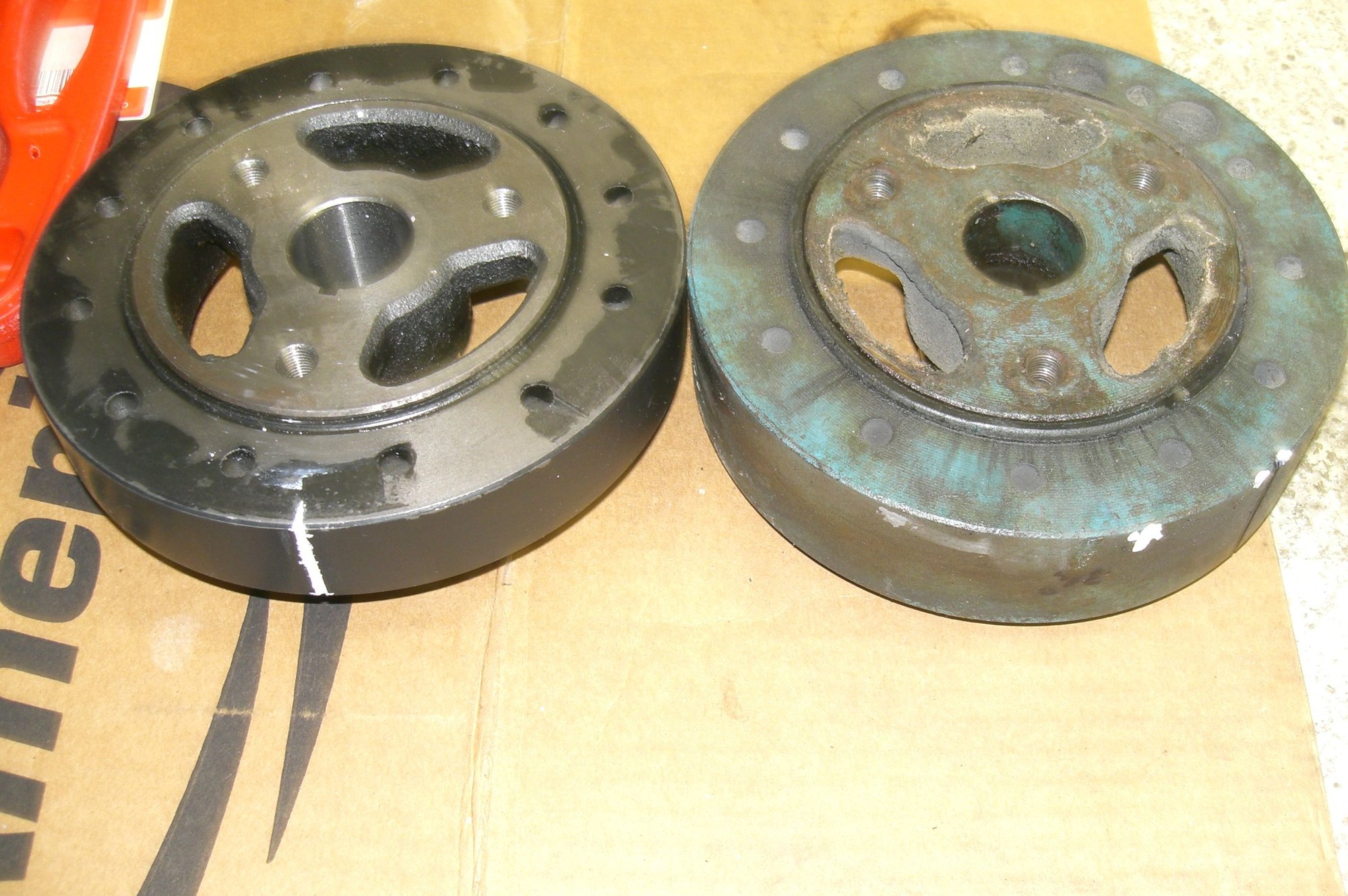

Sounds like a slipped damper. Mine used to show 47 deg at 3000 rpm with vac advance plugged. The black damper is the new one, the white x on the old one is approx where the TDC line should be! Actual timing was 35 deg at 3000 rpm

Your Balancer has spun.
Replace it, it's easy.
