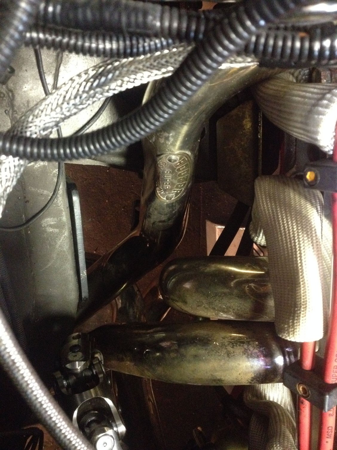

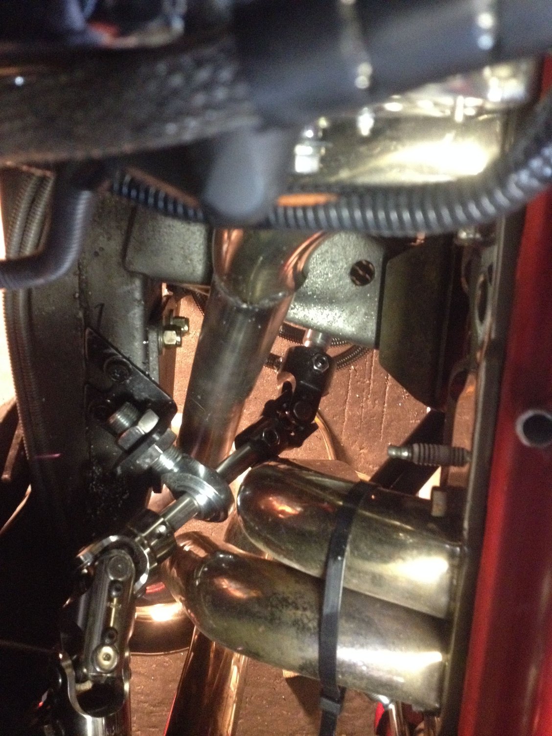

Originally Posted by cboyd
well we got the headers sorted out, had to bend and replace a section of #1 header tube,
This is with the tube cut off>
New pipe tacked in place.
welded header in place.
Shot from underneath.
[IMG]https://cimg2.ibsrv.net/gimg/www.corvetteforum.com-vbulletin/2000x2000/80-
img_2751_90473f7f5f0730b52eae4a76382b134 d2e447996.jpg[/IMG]
Everything runs smooth with no contact between headers and universal joints. HOWEVER, with the steering shaft centered according to Flaming River marks which I confirmed, the passenger side rod connecting the tie rod end to the R/P is approximately 2" short. Has anyone ran into this before or have a solution. I have been trying to contact Flaming River by their 1-800 number but it does not work. As of now I have been unable to contact them. Any input would be greatly appreciated.
Clyde
