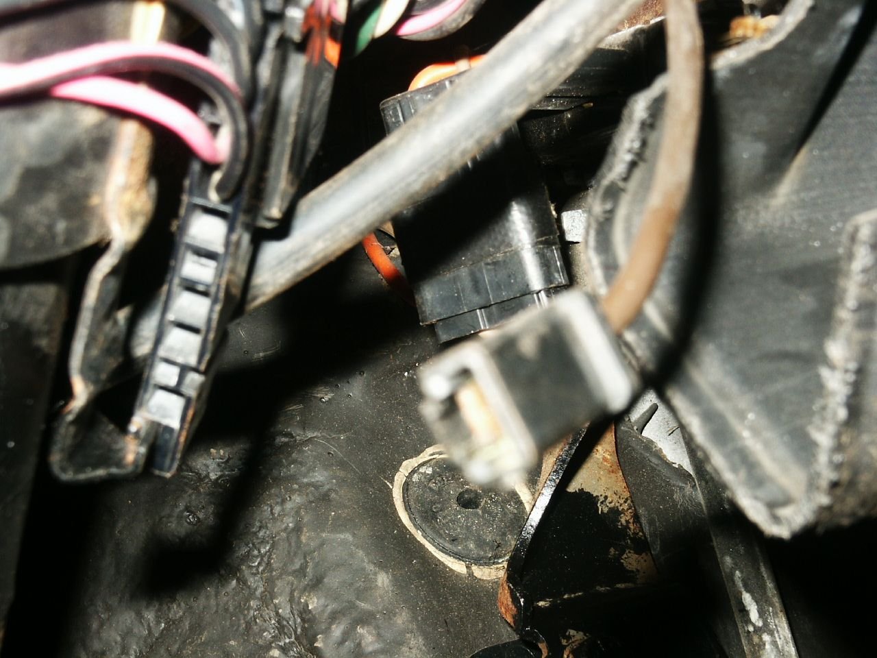

On my 73, I have all my lights( head, tail, running, turn signals, backup, and interior lights) Even the bright light indicator works
when I turn my headlights from dim to bright. My problem is that I don't have dash lights. I can dial the light switch and my interior
lights come on, but still no dash lights.
I replaced all the fuses with new ones, but still no lights.
Also I don't have power to my radio, wipers or fan with the key switch turned on or on acc.
I have found this brown wire under the dash on the right side of the steering column and can't see where or if it needs connected.
Any ideas would be welcome.
Donnie

Donnie, the brown wire connects to a noise capaciter bolted to the steering column near the blue switch. If you have a modern radio you most likely don't need it
Nick

Thanks Nick,
I saw the capacitor. I just didn't think about the brown wire connecting to the black one. Yes, I have the original radio and I can see they connect now.
That answers two questions, the brown wire and why my dash lights don't work.
Now I need to find the problem with the power to all the accessories that work with the key on. (Radio, wipers and fan)
Thanks again.
Donnie
