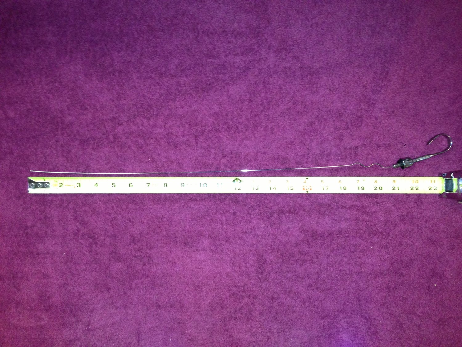

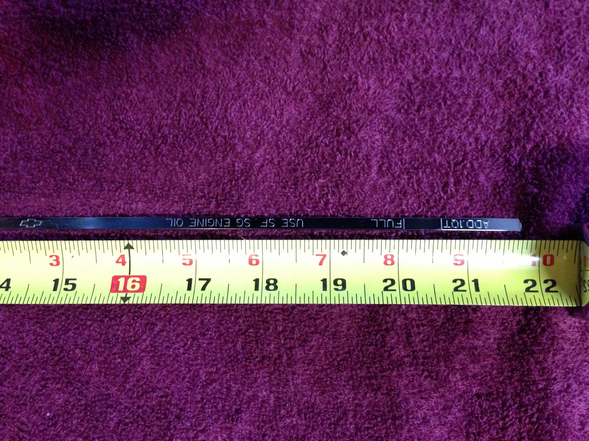

So I want to check and see if my dip stick is the right length. I measured 21.75 inches from the bottom of the dip stick to the top of the bell where it seats in the tube.
Can someone with a 454 please check and make sure my dip stick and amount of oil added etc is correct. I realize my tube might be off as well, but not sure how to check that. Thanks.

Dipstick is 21" from the same measurement points where yours is 21.75", but it's an aftermarket chrome model and the dipstick tube may not be the right length either (too short). I use the AC PF454 oil filter and the oil pan looks to be stock capacity. 1970 Owner's Manual states 5 quarts for 454 without filter change and 6 quarts for 454 with oil and filter change.
With 6 quarts, mine shows to be 1 quart above full. Plan to put my own scribes on the dipstick.

I think that would be the way to go. Not sure if this helps, but with 6 quarts and the large filter my dip stick measures about 1/8 below the full mark. i have the tape zero right at the top of the bell where it seats in the tube.
