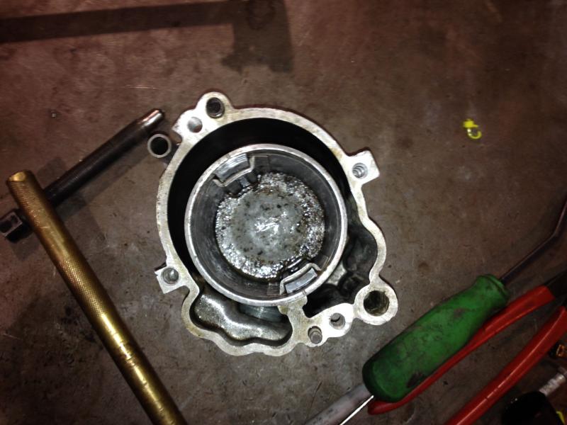

Bought a complete AIR set-up for my 68 L36 car but unfortunately the diverter valve has a bad diaphragm so Ive decided to devane the pump and plug the tube ends for the time being until funds allow for a valve rebuild.
I was hoping that someone has done this before and could help me with a question. I have the rear of the pump off and want to remove the vanes without destroying them but need to remove the rear bearing carrier. It looks like its pressed in but has what looks like holes for a spanner wrench. Has anyone else done this that can give me a bit of direction? Heres a pic if it helps.

OK guys, figured it out, alot more simple than I expected. It is just pressed in and after a bit of heat with a butane torch and few sharp hits with my slide hammer it came right out. With the retainer out of the way the vanes were easily removed. Runs quieter/smoother now and one less failure point. Anyways, thanks for the advice and I do intend on rebuilding the diverter valve eventually which is why I wanted to de-vane the pump w/o destroying the vanes so I could reassemble it then. Heres the pics. BTW, does anyone else other than Bill Hodel rebuild diverter valves?
