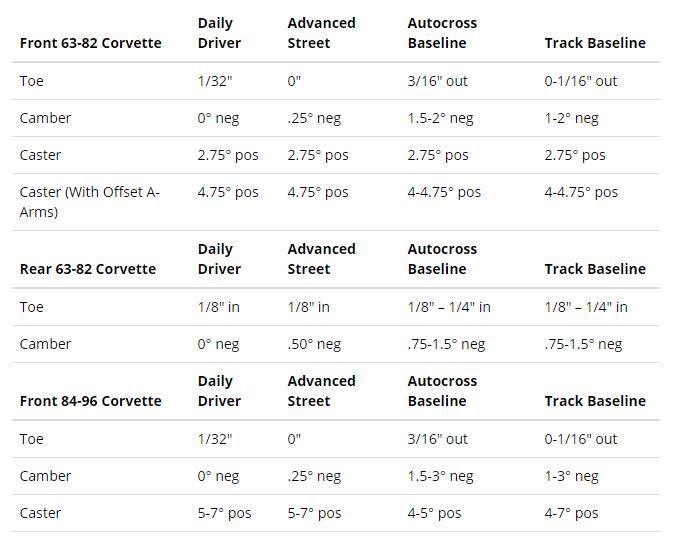

Honestly, I wouldn't crank in any more front toe than necessary to satisfy your straight-line stability requirements. Suggest you download and study the alignment info found here, as these recommendations should give you as good of a baseline from which to work as any...
https://www.vbandp.com/index.php?opt...=43&Itemid=131

Toe in overall 1/32" to 1/8"

The old school GM specs are for old school bias ply tires.
I suggest you use Van Steels recommendations for radial tires.
You need caster 2.5 to 4.5*, the more the better, to get much self-centering.
