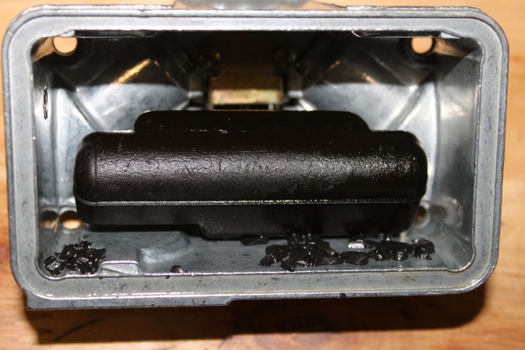

I had let my car sit with a mostly full tank of 10% ethanol gas for almost a year. After I started driving it again I was having a hard time keeping the car running during idle. Noticed fuel pouring out of the rear vent tube. Took off the rear float bowl and saw this
The rubber turned to mush when I touched it. I ended up siphoning all of the gas out and replacing all the rubber fuel lines. No more ethanol gas for my vette or lawn mower
That's why you replace them with hoses made for ethanol blended fuels. This is not an insurmountable problem.
And if you replaced the hoses odds are the new ones are ethanol compatible.
As for lawn equipment: I put stabil & MMO in the gas. I don't drain the tanks for winter. Both my lawn mower and trimmer starts right up in the spring. The lawn mower is 11 years old and has run E10 since new. It runs perfectly.
