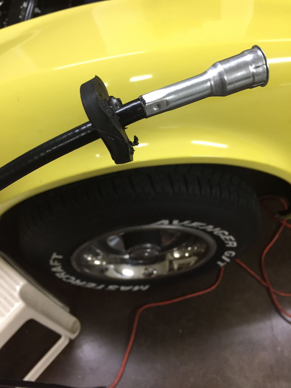

I had to get this speedo cable grommet over a new speedo cable for my 1981 coupe w/o cruise. Here's the gromment… http://www.corvetteamerica.com/part-info?partno=X2577
I also bought this "tool" which was a $9 error... http://www.corvetteamerica.com/part-info?partno=42280
Using the 3/8 extension is the way to go. Worked perfectly. Used 3 in 1 oil as the lube. The extension is the perfect size for the speedo end of the cable. The tool was not even close to appropriate for this job.

Your part number EC18 / x2577 is the grommet I just said was easy using DUB’s method. No cutting. Took about a minute to do. It is the exact same grommet as original that I removed from the firewall.

That tool wouldn't work on an 81. No threads on the cable end.

well holy crap it worked easy.
Haaaa I googled how to get speedo cable through grommet and this old thread came up.
