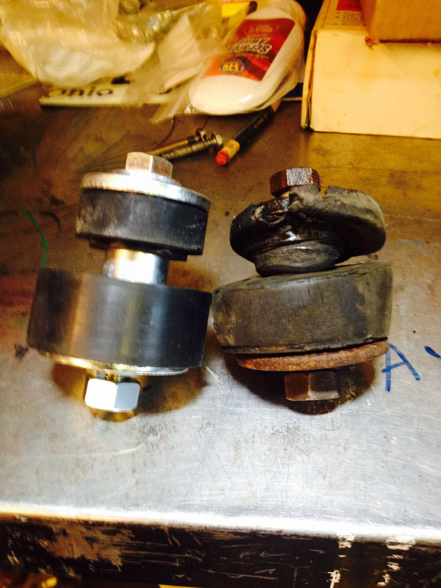

These snubbers needed some attention…

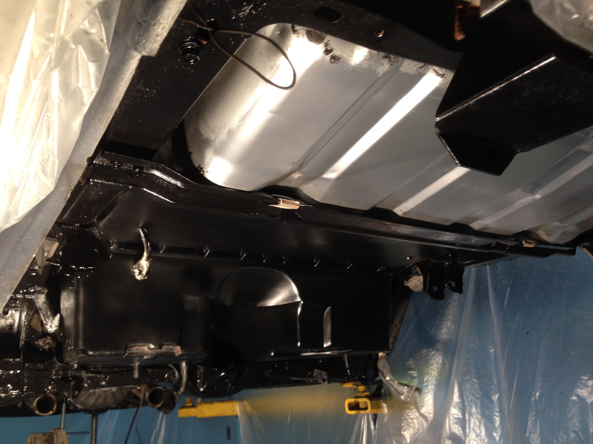

\I thought about painting the floor but after some cleaning, out came the original fiberglass. I'll paint only the frame and suspension so the non-judging eye won't know the difference, I'm one of those that like having a clean under side.
