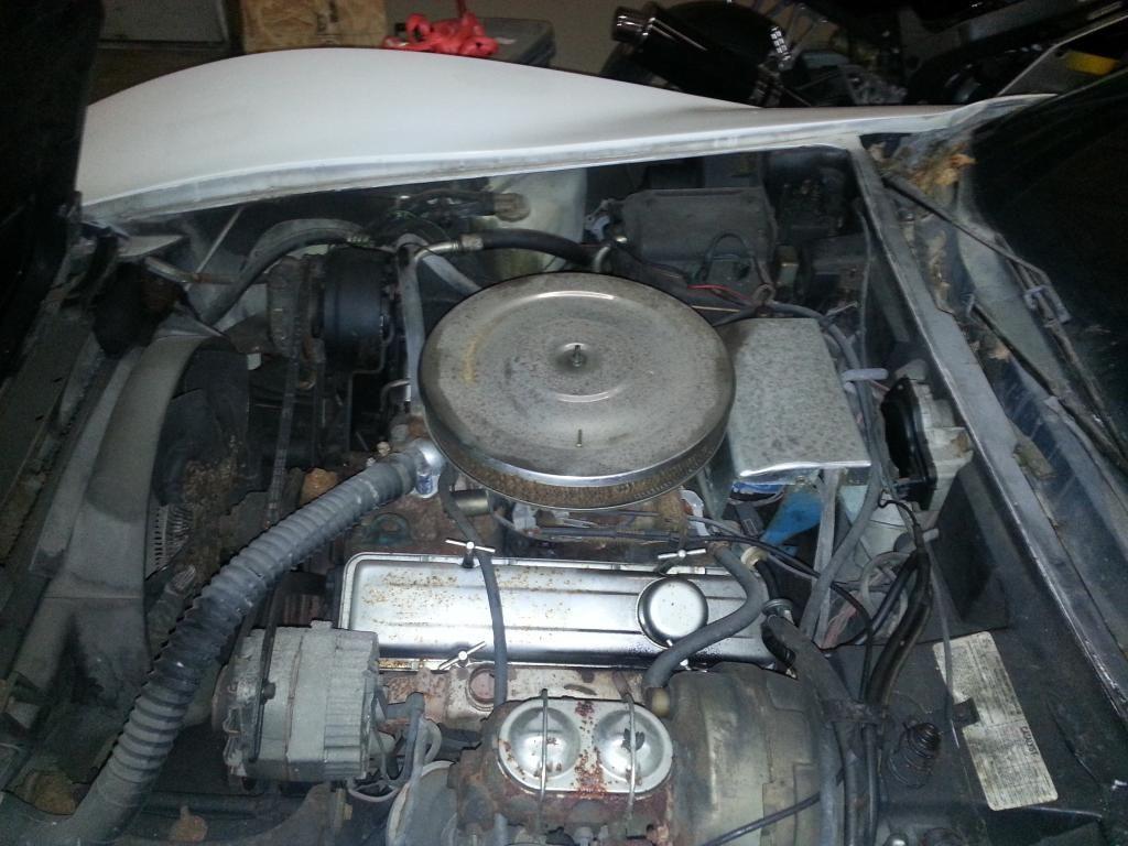

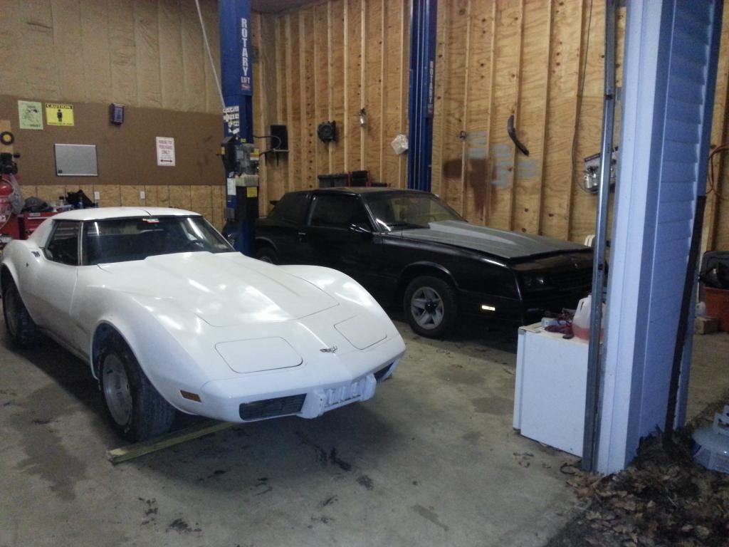

So I figured I would start a "build" thread of sorts that I could ask questions and get advice from the C3 gurus and also as a place to document what may be a long journey....
Patient:
1977 Corvette
350 SBC
Automatic
Prognosis:
Undetermined as of yet, but it has been under a cover in a garage for 23 years before it was given to my wife by her aunt and uncle.
I am not a mechanic by trade, but I like to think im pretty good with my hands. I can usually get most things done with direction....and asking a million questions to make sure I don't screw up.
That being said...what do you guys think should be my first course of action with the car? The motor hasn't been run in a very long time. I was thinking of seeing if I could get the motor to turn by hand before I try anything else. If it did then I would change the oil, and possibly drop the fuel tank and get some new fuel in there.
Thoughts? Any links to good resources for this project....pointers, etc?

I will tell you what I did from my own experience of mine setting under
a tarp for 20 years. I first removed the spark plugs and shot marvel mystery oil
into each cylinder and let set for about a week while I checked other areas.
When I was ready to check out the engine, you may need to remove the belts,
I took a socket and breaker bar and slowly turned the engine over by hand to check if everything was free.
Mine was easy to turn over, so I felt it was ok and it was.

get the engine running , make sure the trans goes into drive and reverse rebuild the brakes change the fluids and have fun.

Yea I need to find some free time to get into the garage and start working on the car. Working full time and grad school part time is a real time sucker
I will be very happy if the motor spins and I can get it running fairly easily. That would give me some time to finish the Monte Carlo SS
