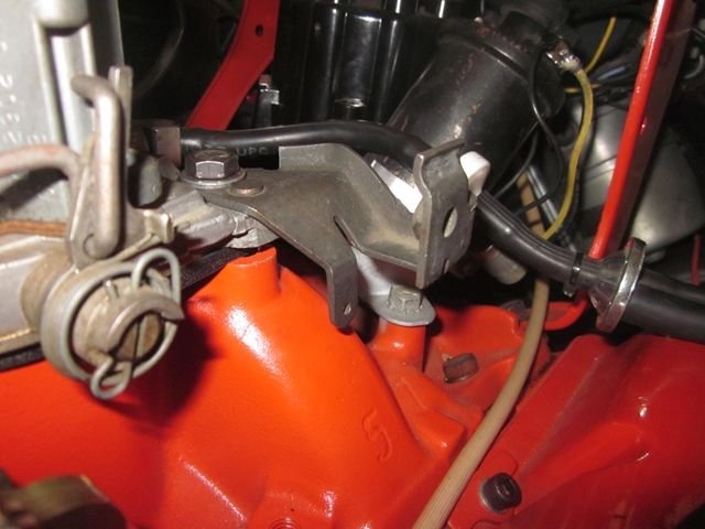

the BTO ez tv cable set up comes with a plate that goes under the carb
but unfortunately it fouls with the std '72 vette quadrajet throttle cable mount.
so will have to modify/make a new bracket at work during the week.
have a car show next weekend, so hope to start the swap after the 16th feb.

made a bracket at work to hold the throttle cable and the ez tv cable
original
my attempt, excuse the poor welding
