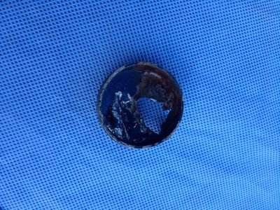

Default Out wuth the old, in with the new
After three hours of trying to find and finally make a puller I got the old plug out. Tried to tap in one side so the other would pivot out and the whole thing just started to go inward. Punched a hole and made a slide hammer out of threaded stock, a 3/4 drive socket for the slide and welded a cut off hex wrench to the end and pulled the sucker out.
Tried the tap a tap method but there was no room to get a run on the plug with a hammer. Used the socket and engine weight method along with a wedge pry bar and got it in flush with the block.
Gave me fits!
Up and down with the engine and installing the socket and repositioning the socket.

Too bad it popped into the block - good idea on the mini-slide hammer.
How'd you get the hole in the plug to insert he slide head?
Pressing the new one in using the engine weight looks less risky than tapping.

It didn't go all the way in just started to go in so I went a different direction. The hole started with the rust hole and I just enlarged it with a pointed punch.
