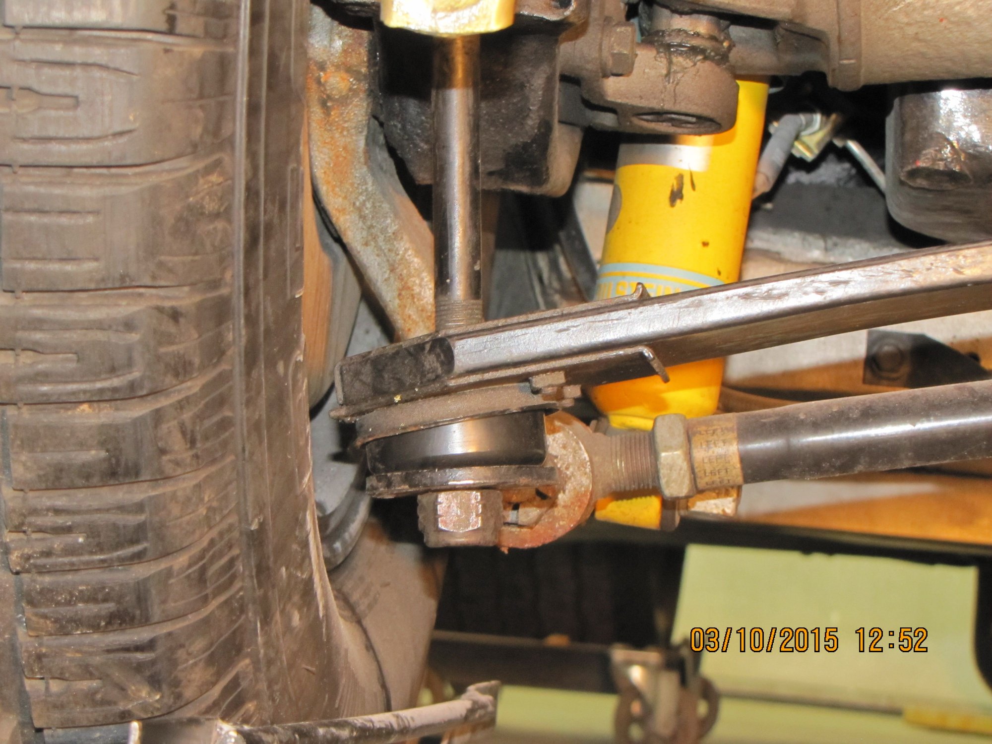

I know it's been awhile since I started this thread but have been out of town. Today I took some pics of my rear suspension. I appears to me that the spring is too stiff. I put my full weight on each side of the car and maybe lowered it by max an inch.
This pic shows the remaining curl on the spring with the weight on the car and a full tank of gas. The spring curl is parallel with the half shafts. I did a test with the spring disconnected and lowered the car until the half shafts were parallel with the car and the ride height looked good. Approximately 1-1/4" from fender to tire.
I have 10" bolts on the way, but think that will bring my spring end too close to my tire.
This pic gives a general idea of the fender to tire clearance both front and back. Once I have the back sorted I have to tackle the front.
I guess my question is, is there a difference between spring manufactures. If so what are you guys using?

The 78/79 C3's all seem to sit low in the back and too high in the front. I have had 550 springs front and a 360 VBP rear spring for years and the stance was a little too high in the front. With the L-82 rebuild last Spring 2014 and the addition of aluminum heads, the front is way too high now. I am thinking of cutting a 1/4 coil off the top AND bottom of each coil this Spring-looking for a drop in the front of about 1-1.5 inches. BTW-with 255/45/17 ZR tires and the above springs, the car has never rode better…and handled as well. Bilstein HD's front/Bilstein Sports rear.

i have the VBP 360 spring and with 10" bolts it sits slightly high but i have 275-60-15 Drag Radials in back so it really sits nice. other spring mfg's springs sit a bit higher.

Its not necessarily that your rear spring is too heavy; but it has too much arch. TRW design fiberglass springs consistently have too much arch. There are countless threads on this forum documenting this. Best bet is get a VBP spring. They make their springs in house and they have been doing it a long time.
TRW design springs all come from Muskegan Brake. They outsource the manufacture of their springs. They are aware that their springs have too much arch but have chosen to ignore the problem.

This is what I have been trying to get at. With no weight on my spring u can use it for a bow. I will probably use the 10" bolts to set ride height for now so I can do my front, but order a VBP before I take her out in the spring.
