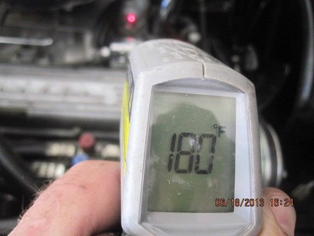

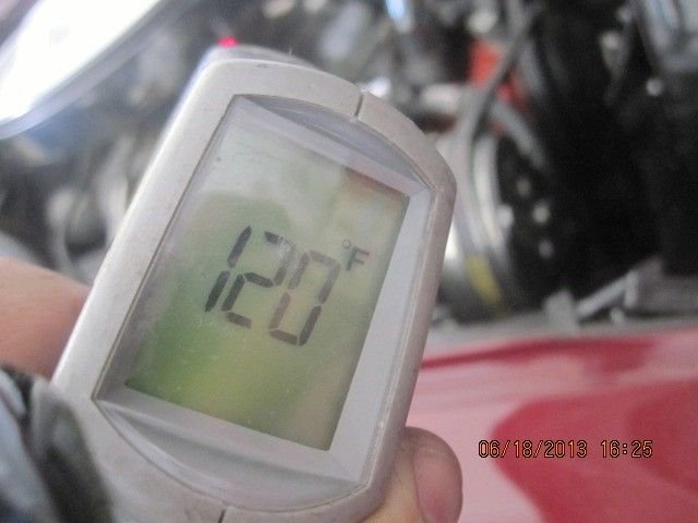

I agree with other here regarding the flooding condition...look into the carb. I experienced a flooding condition that had me pulling hair (and I ain't got much). Turns out I had a tiny hole in the metal float of my 2818-1 Holley. When she got warmed up (hot), the hole expanded and sucked gas into the float. When she cooled down, the hole closed up and the weighted with gas float caused my excessive flooding.
Fixed it by replacing the float and while I had her off the intake decided to put an aluminum heat deflector that Mr. Gasket sells in place.
Here's my posted topic on my flooding condition and heat shield install:
https://www.corvetteforum.com/forums...ok-a-year.html
and here's some pics of temps at idle, fully warmed up. Quite convincing. The shield REALLY works to prevent percolation/dieseling.
The IR gun took the temp at the thermostat housing
Then I pointed the IR gun at the primary bowl:
Jim
