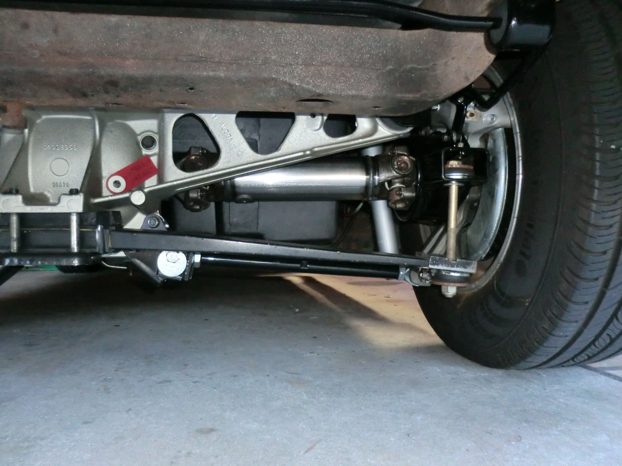

Agree, I have heim joints on the strut rods as well and the ride is very comfortable.

Very nice clean setup...

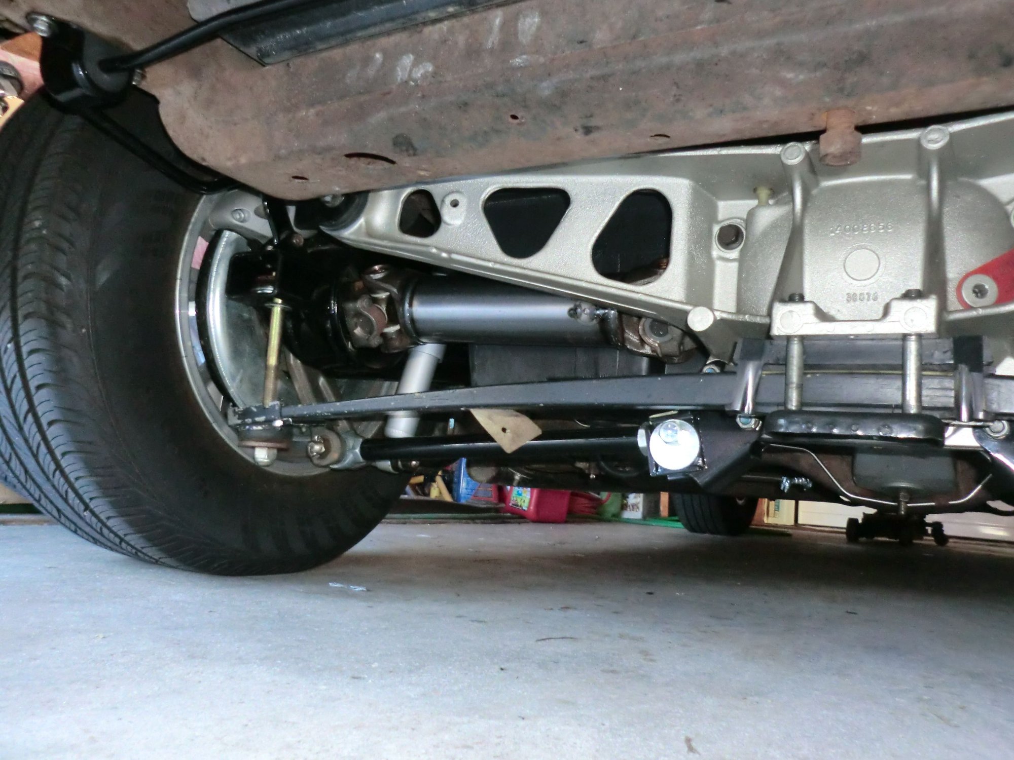

BUT...what is the MOST IMPORTANT PART...that many may not know or have picked up on is....NOTICE the position of the concentric bolts for each strut rod where it is bolted to the brackets UNDER the differential. The position of these concentric bolts are the SAME....even though he used adjustable strut rods. The positioning of these concentric bolts can drastically effect the suspension and provide different characteristics. SO...if the heads of the bolts were BOTH at the 6 o'clock' position....it would change how the rear suspension would function...and the same as if the drivers side head of the concentric bolt was at the 9 'o'clock position and the passengers at the 3 'o'clock position. It make a difference and he paid attention to the fine details and NOT just tighten these concentric bolts in whatever position he felt like and then adjust out the strut rod for the camber setting.
GOOD job....for whatever that is worth.

Anybody notice anything that doesn't quite "fit" in these pics?

I like Global Wests stuff. Not knowing what you used...but in your previous photo you used the factory concentric bolts....but in the kit in this photo above use the square plates where you can position the angle of your strut rod to achieve different suspension dynamics. I like the Global West option by how they are drilling the 3 holes in different locations.
I always weld the strut rod bracket where the concentric or square washer is installed so the spot welds do not fail and allow the strut rod to move. It never has done it to me...but I figure...why not when Vette Brakes and Products recommended it over 20+ years ago.
Truthfully..I do not know if I would have commented on your question correctly 'Kid Vette' and that is due to many manufactures make things there way....and I would have to have had your original strut rod laying on a table and match these new ones up to it so when the new ones have been threaded in all the way....I could compare them.

The 3 different hole positions in the square plate...which is basically the same as turning the concentric bolt for each side....changes the angle of the strut rod.....and changes how the car handles. It gives a person options for handling depending on what they are using the Corvette for versus the square plate with the hole in the middle.

I used plates similar to the global west design with the 3 holes to tune the camber curve of the rear suspension. Depending on the vertical location of the inner pivot, the amount of camber gain changes. Using these plates with VB&P's bracket I was able to adjust the camber gain to my liking.

I went with the VB&P Smart Strut Brackets because they lower the inner pivot point of the strut rods 1/2" as Greenwood suggested. This lowers the roll center and reduces camber gain. The stock geometry has a too high roll center and therefore a jacking effect.
Then for drag racing you rotate the cams on the bracket 180 degrees which lowers the inner pivot to its lowest point and reduces camber gain to almost zero which is what you want. This increases contact patch of the tires on squat when you launch.

IF you still have the FACTORY strut rod brackets still attached to your differential....NONE of this matters....and this is beacsue the slot in the factory strut rod bracket is horizontal....and only allows the strut rod (original or adjustable) to move in and out.
The strut rod brackets on 'KidVette's' car are different where the slots in the brackets are angled allowing the strut rod angle to change when the concentric bolt head is rotated.
