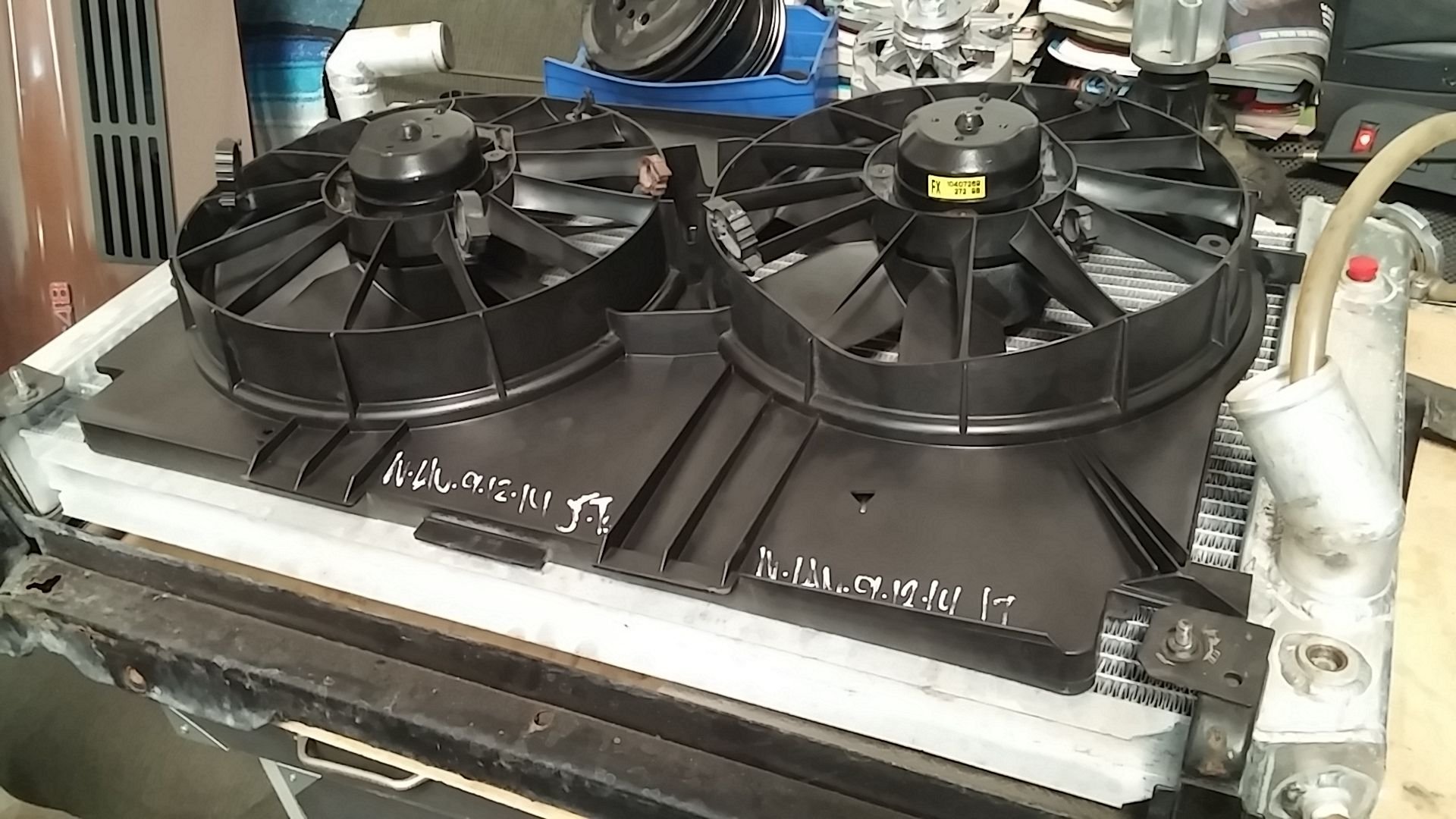

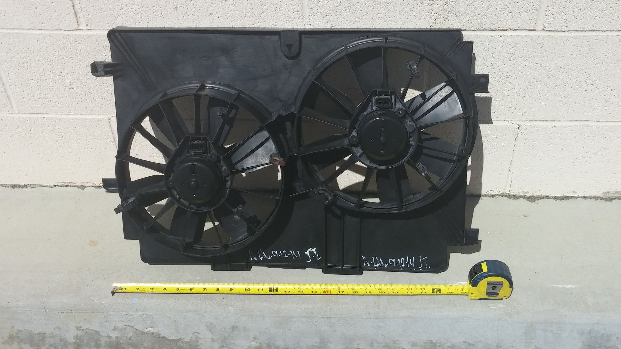

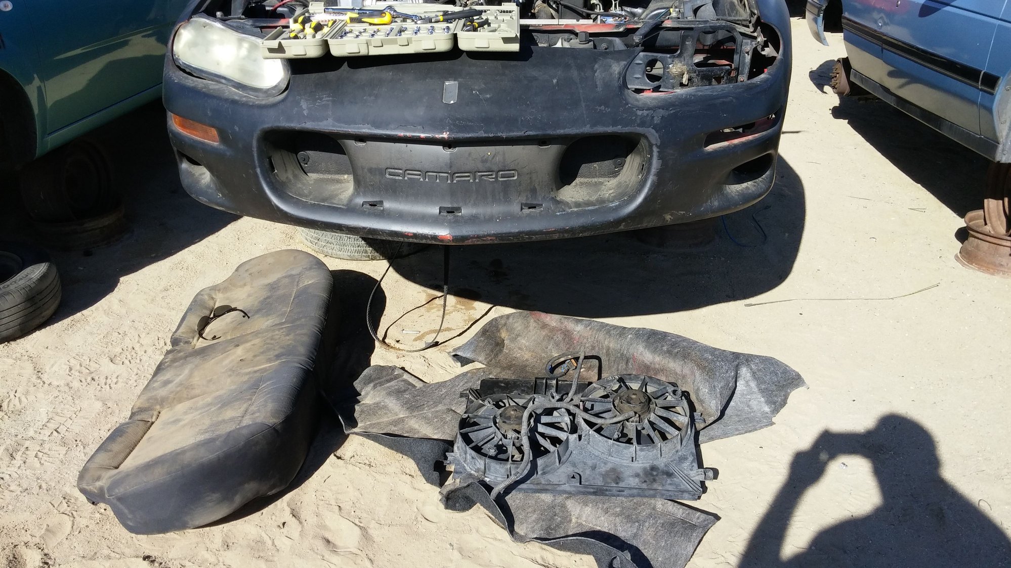

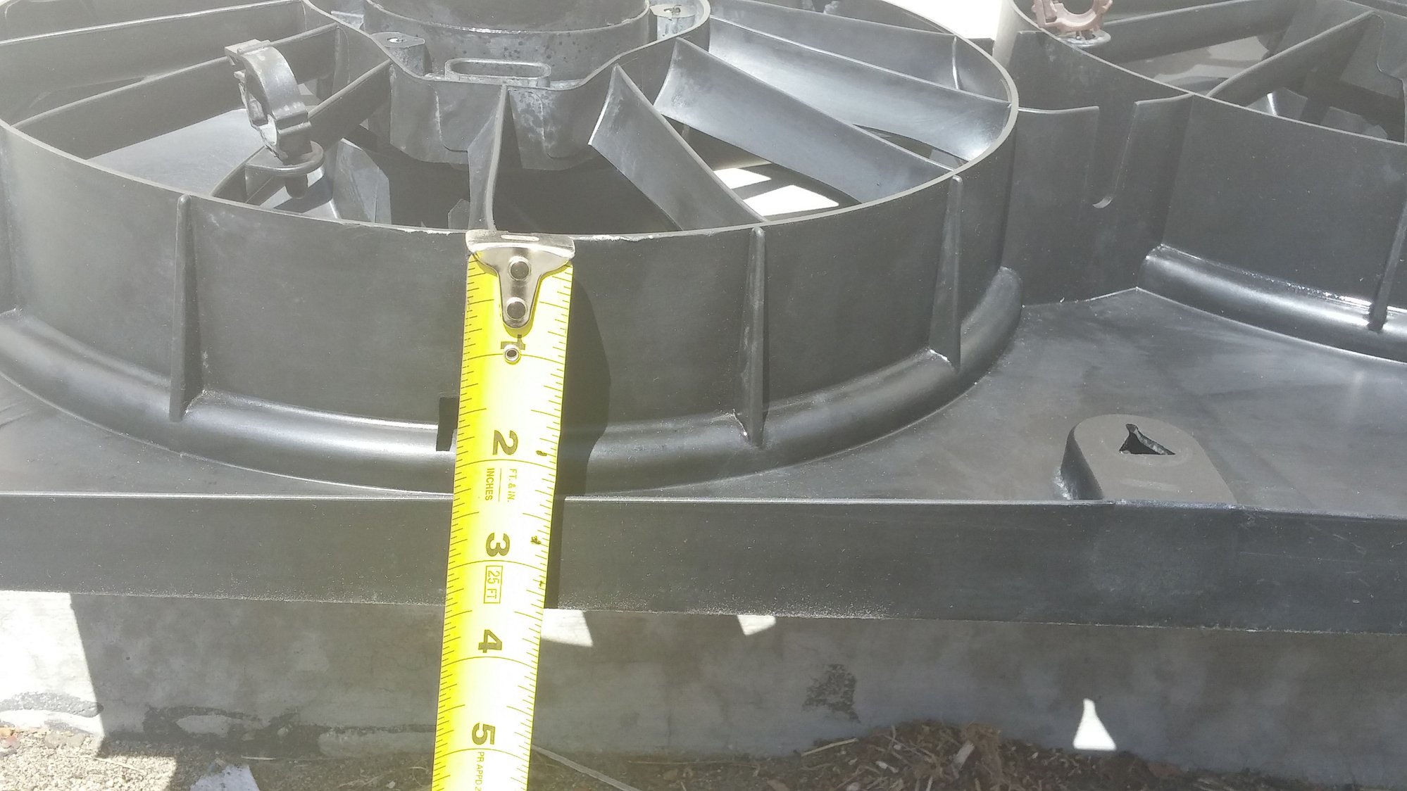

$40 at the Wrecking Yard, V6 Camaro.
Cleaned up, really well!
For sealing all the way around. Use dense rubber foam and cut to fit. This is important! No gaps or holes, because they reduce the efficiency of the fan.
I did this for $80 and even the motors are replaceable at any auto parts store.

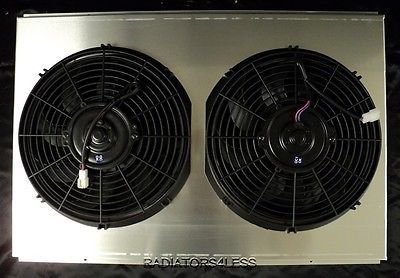

I went with this shroud and dual 12" fans off ebay. It fit nicely, looks good,and does the job cooling. $169
http://www.ebay.com/itm/NEW-ALL-ALUMINUM-RADIATOR-FAN-SHROUD-W-12-FANS-1977-1982-CHEVY-CORVETTE-/271745235515?pt=Motors_Car_Truck_Parts_Accessories&hash=item3f45473a3b
