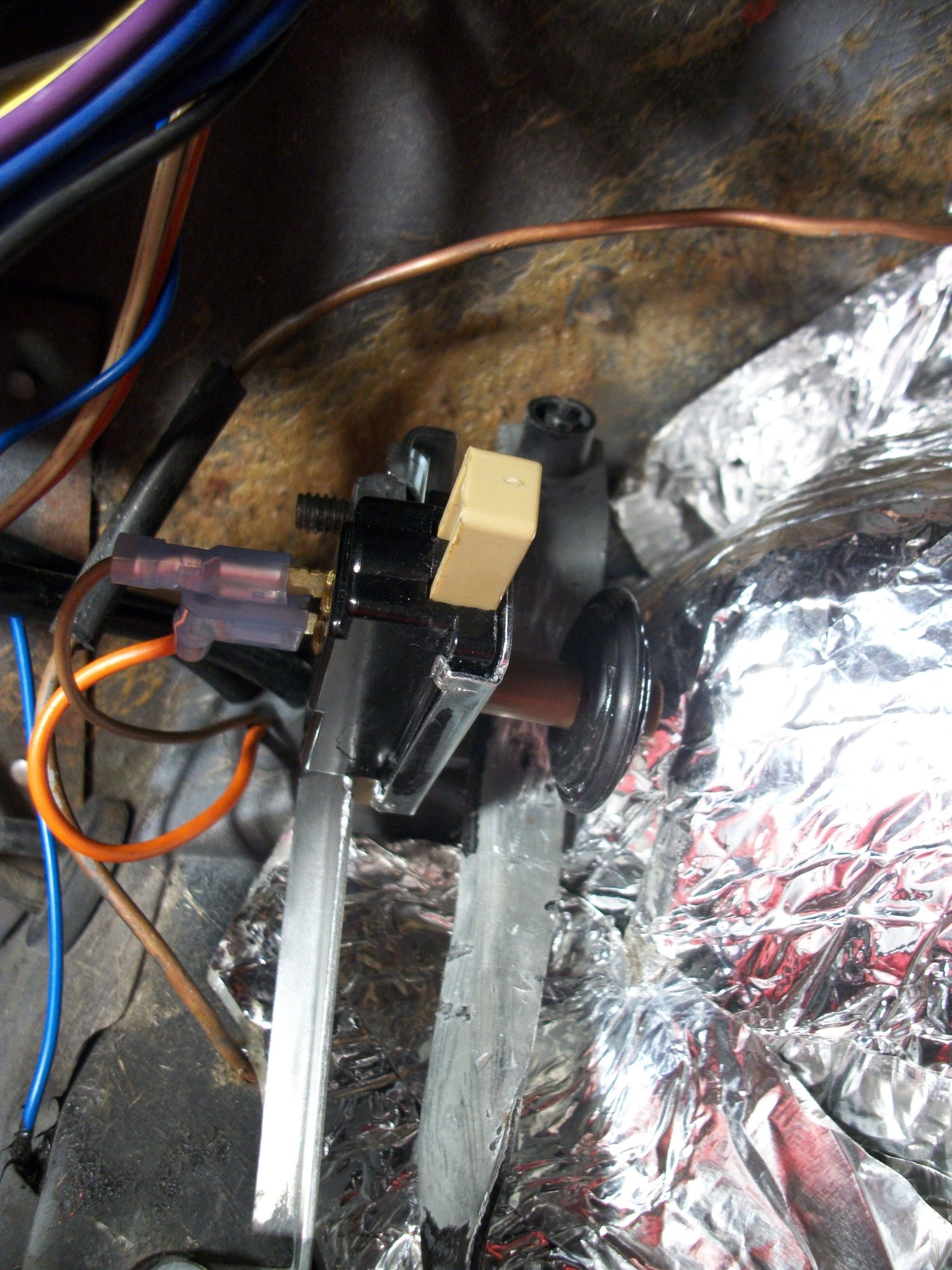

I just fixed my kickdown switch on my '73. I purchased a new one from Eckler's corvette for $30.00, installed it within 5 minutes and it works perfectly. I did add some 3/8" rubber hose to the top of the gas pedal as well as a small piece on the round part of the switch itself to ensure it made contact.
BEFORE, adding the switch the car was no fun to drive but what a difference after installing this! It woke up my engine and its pretty exhilarating when the tranny drops to 2nd gear, RPM's rise and you blast down the Hwy.
I'm also running the original 3.36 gears on my car. I think if I was running a 3.73 or higher I may not want the kickdown switch installed as the RPM's might increase too much, I'm not sure though.
Old Sep 4, 2015 | 11:22 PM
doorgunner's Avatar
doorgunner
2026 Loser of the Year
Posts: 36,601
Likes: 7,046
From: New Or-leens Loo-z-anna
The switch was broken on my project......I replaced itbut still haven't driven the car yet......I also added a 1" diameter black rubber grommet onto the switch sliding rod so I wouldn't have to floor it in order to go into passing gear/now it should kick in at 3/4 throttle.......
