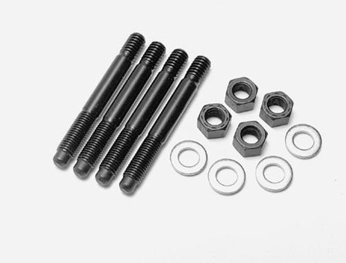

Use studs in the intake, then a nut on the stud after the carb is in place, I do not believe it will leak, but if you want to really have piece of mind before you install the stud in the intake put some silicone sealer on it,
Stud kit
