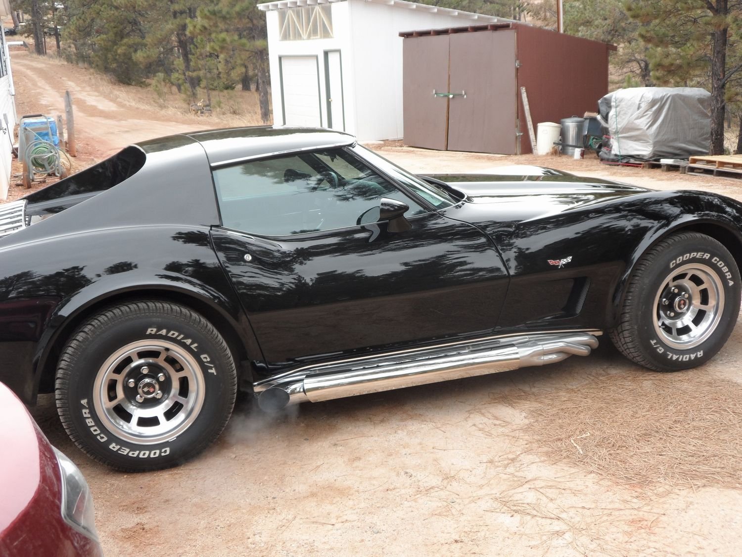

I have a 77 that I'm running cooper radials. 255/60 on the rear 225/70 on the front. The 255's are too wide for the front. Even the 225/70's rub just a little at full lock. Here is what it looks like.
