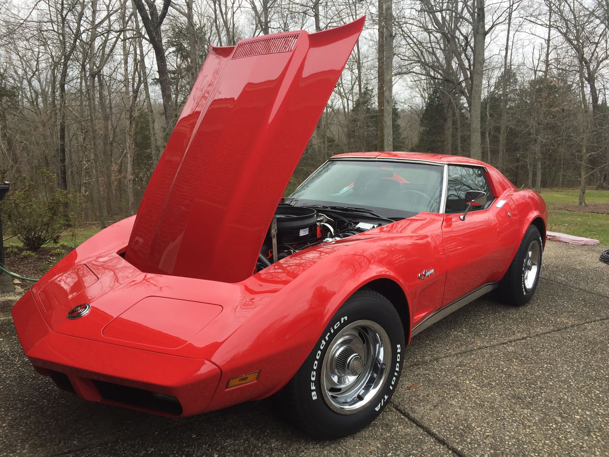

Just recently installed a set of Goodrich 225/70/15's on my 74. I think this is the size that looks best.

Originally Posted by TX-Techman
My 69 had 255/60R/15s on the original wheel when I purchased it. They did rub on the front when turning hard. These are 215/70R/15s all the way around which are equivalent to the F70/15 Wide Ovals that were original equipment. Great improvement in ride and handling with no rubbing.
Stunning car
