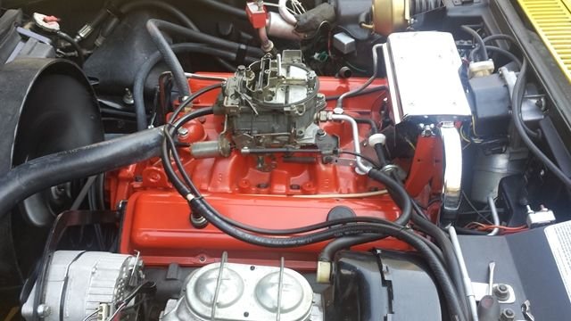

350 auto with power brakes
is a problem showing when you put your foot on the brakes in park/netural/gear, and the rpm's rise by a couple hundred?
or is it normal?

That is not normal, and you may have a vacuum leak in the line from the back of the carb to the brake booster. Disconnect from the brake booster ,plug and re-test.

only has a short hard line and a short piece of hose.

That is correct. Remove from the brake booster and plug the line to the carb or connect a vacuum guage on the hose. Then when you apply the brakes see if the vacuum continues to change.
