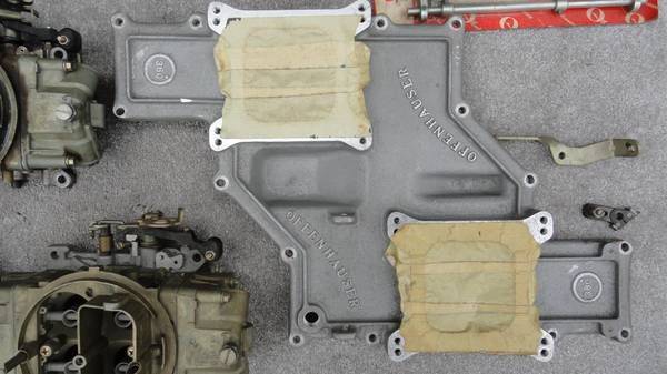

Old Feb 21, 2015 | 02:21 PM
76Rat's Avatar
76Rat
Joined: Jun 2013
Posts: 484
Likes: 43
From: NJ
Originally Posted by c3cruzn
option 1, new cam, different heads and then going to dual carb setup with slip linkage. Oh and a set of 353 gears.
Gary
Oh baby!
Link to setup http://newjersey.craigslist.org/pts/4883442007.html
To fuel injection kit or other options
