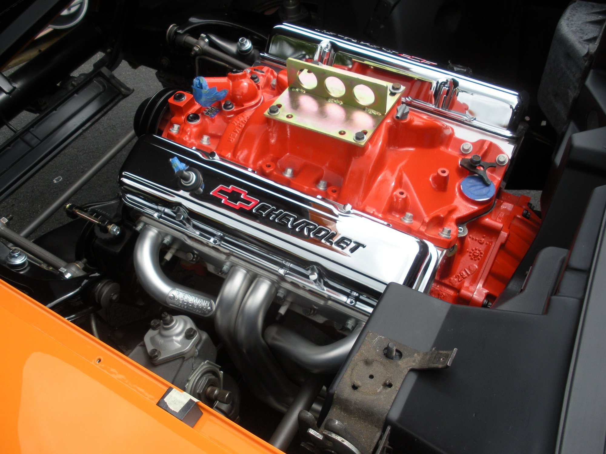

Now that I am going Quadrajet, I need a new manifold. Tell me why I need a Performer RPM Quadrajet instead of a straight Performer Quadrajet or Performer Air Gap with the following engine:
ZZ4 Short Block
AFR 180 Eliminator Heads 65cc (10:1 compression)
Factory Hydraulic Roller Lifters
Comp Cam Extreme Energy 270HR (218/224 @ 050, .500 lift) - Advertised at 1500-5400 RPM operating range
Hedman 1-5/8 Inch Headers
Magnaflow 2-1/2 X Flow Exhaust
Four speed Manual Transmission
With the cam operating range at 5400 RPM, why bother with the RPM manifolds?? The downside to the RPM is the need to go drop base aircleaner. With the straight Performer or Performer Air Gap I could use larger open air filter OR even my stock 77 cold air system (although concerned about the small opening that may be choke in the system), all original parts i.e. throttle bracket and fuel line. I have read enough to know that what matters is matching cam to the heads to the intake and driving style. I am not going to race the car, so RPM above 5500 RPM is not my concern. My biggest hangup is spending the extra money on the AFR heads to choke it, even if its only a matter of principle??

Another aspect of this for consideration....I ruled out the stock 77 single snorkel air cleaner, because I think it will be restrictive and not interested in the later model dual snorkel.
Option 1 - go with straight Performer or Performer Air Gap and I can use a standard 14 inch open air cleaner, maybe 3-1/2 inch K&N. Everything easily fits, and looks good.
Option 2 - go with Performer RPM Quadrajet, I will have to use a Drop Base air cleaner due to the .75 inch taller as I intended with the squarebore Performer RPM in the picture. Does the drop base restrict airflow, due to smaller distance between top of carb and floor of air cleaner top floor, possibly negating any advantage the Performer RPM has over the Performer. What do you think? Overthinking?

I use a Performer RPM Air Gap, but I use a Holley Street Avenger.
I also have an L88 style hood with the air filter in the hood and cowl induction. So no clearance issues and lots of cold air.
I have 400 hp and tons of torque.
