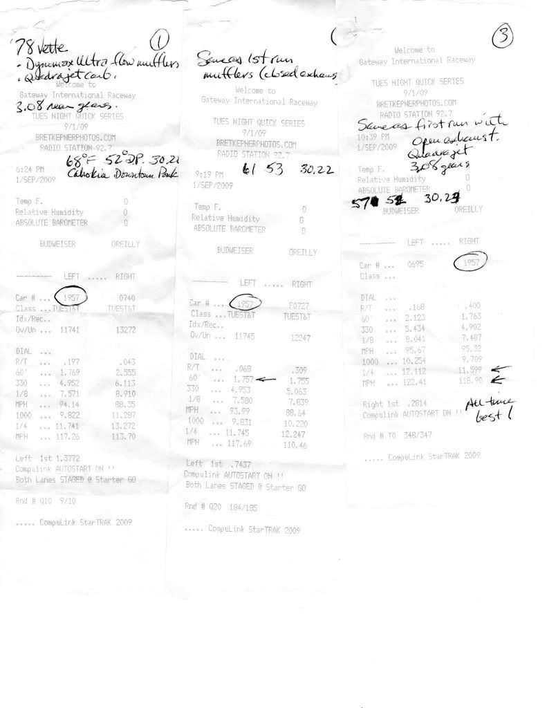

I'd not worry about any adverse comments about the Quadrajet. I had one on my '78 vette with a Performer RPM Q-Jet (not an Air Gap) on a 406 that I built. Not only did it run mid 11s with 3.08 gears and a TH-350 trans, it also got 17 mpg on the highway.

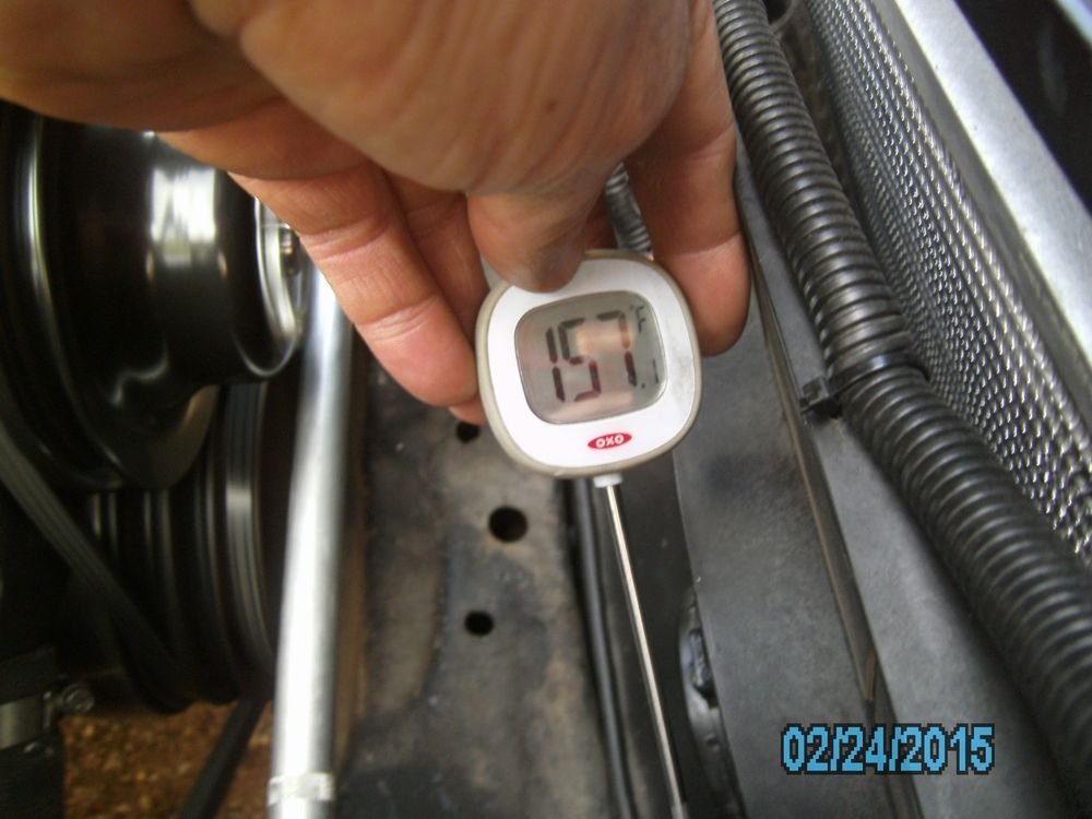

So I collected some data today.
Outside air temp was 55*F
At only 55* F and idling, so no driving had taken place to really soak the engine with heat yet, I recorded a temp just aft of my electric fans while they were running of 157*F. This may not normally be possible without risk to limb with a stock fan set up. Also not possible while driving without a remote temp sensor mounted just behind the radiator to record the temps, which I do not have.
Water temp is shown here. This cap is accurate as checked with a non contact thermometer and the gauge inside the car.
190*F on the water temp and you get 157* after the radiator at an outside temp of 55*. Imagine if it was 90* outside.
Then I decided to measure the temp just outside the airbox on top of the stock intake air duct.
I am a bit surprised that even on a 55* day the air around the airbox still achieves the same temp as the air coming through the radiator. I thought it would take a hotter day to get to that kind of temp and after driving a bit.
Now I need to see what it is on a 90* day after extended driving. Could be even higher.
