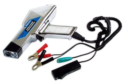

Today the new gun arrived, its a Gunson Supastrobe, and it works with the MSD box.
But despite that, this thing is a dinosaur. Big, heavy, you need 2 hands for adjusting the advance and the display shows only one value a time. Just no joy using it. With the other light i was able to track the advance at any engine speed while raising the rpm with the other hand.
This time I was just happy to see the timing advance stop at 36°, no clue what rpm it was. But i know it´s around 2500.
Luckily I will not need this timing light very often.
