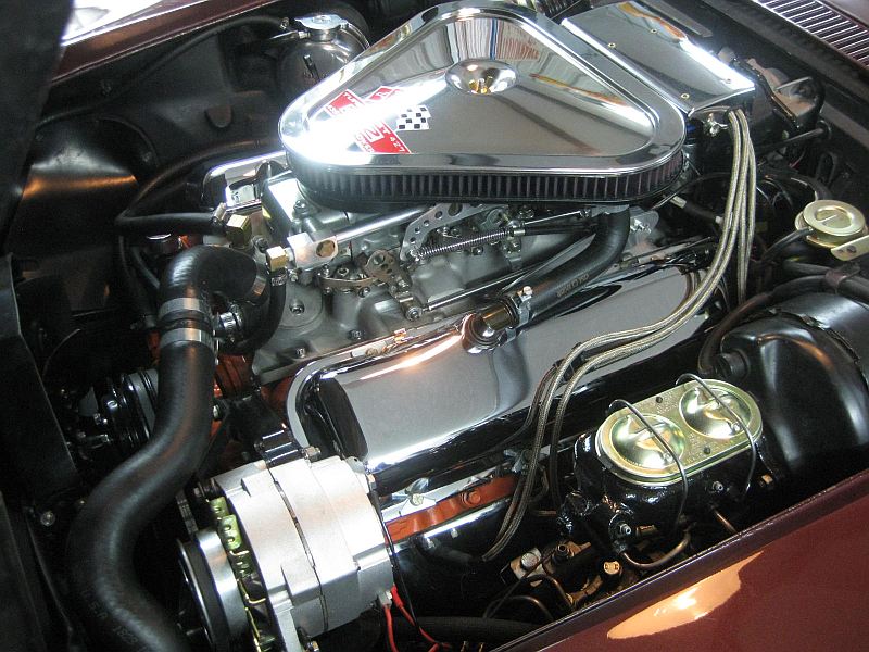

Well... I bought the zz502 because I wanted a stupid solid engine that would run without problems until it´s worn after many years.
I put my Demon Sixshooter on it that I already had. It´s basicly all Holley stuff.
And I keept the original TI-system which should perform like a modern HEI-system. It´s set up to 36° with additional ~10° vacuum.
Here´s a pic for better understanding:
Had around one year after a lot of tuning and it run very good.
Then it started with slightly vibrations when cruising in high gear close to idle load. It feels like little missfires. It gets instantly away when you slightly accelerate.
After checking anything without results I changed timing in small and big steps, with and without vacuum without any result.
What helped a bit was richen the idle mixture and transistion circuit.
But I won´t go richer anymore, now I have black plugs, that´s not so good either and the problem is still there.
Well I am out of ideas. Haven´t checked the valve adjustmend, but don´t expect to find something (hydro lifters).
Choke is working correctly.
Im out of ideas now. Could it be something is wrong with my old TI-system? Yesterday I had also missfires under hard acceleration, but thinking the carbon black plugs could be the reason for this too. (New plugs are ordered already)
Now I think a MSD ignition box could help with it´s stronger sparks.
