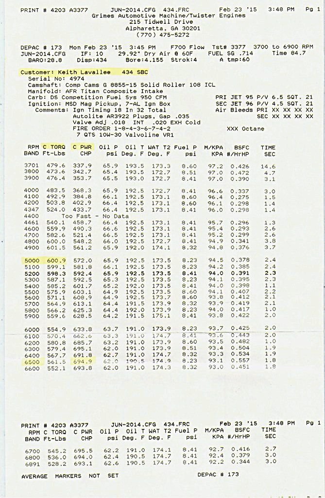

Originally Posted by KJL
So your are looking for the engine dyno or chassis dyno results?
Maybe he means a video?......Engine data results are posted on post #60 of this thread.

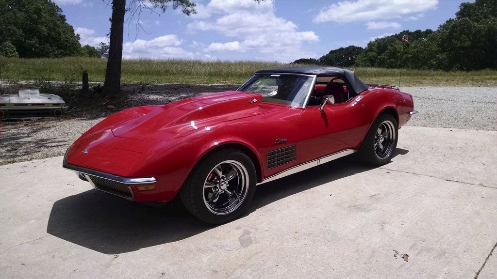

BTW.....What size is your cowl hood....it looks like a Glasstek 5".....how tall is it?
Thanks, no picture for me, says something about photo bucket, maybe some one could repost it?
photo bucket pulled out of the freebies so everyone who ever posted using them are screwed unless u pay. I will scan and upload. I do not have raw data from chasis dyno. Only curve.

Default Dyno results re-posted
Here ya go........

Thanks for reposing it and the link! Hopefully others are aware of this. I recently created a thread of my experience hand porting the top end of a 92 ZR1 posting many pics via Photobucket. They pissed off a lot of people when they changed to pay per view. I was not happy to see all my pics vanish.
My cowl is about 5.25" at the highest point. I forget where I got it. It has been many years. Fit like crap. I had to make it fit. It was too narrow and too short. The hood hold-open latch bosses were in the wrong place...... I could write a book on that experience. Most of my mechanical knowledge over the years has been gained by having to make "direct fit" bolt on parts actually fit.
BTW- 5" is what you will need if you ever want to run high rise intakes and spacers. I am currently running the Titan race single plane intake with a 1.5" spacer and non-drop base air cleaner. My filter is K&N 2"x14"dia. I used to run a dual plane airgap with a 2" spacer. I may try the dual plane titan spider with this new engine config to see where the power goes.
It was a tough decision going with the 5" because of its size bit I am glad I did. One of the best upgrades I ever did. Gave me all the room I needed to play over the past 18 years.

Thanks for the response. Judging from your pic, the cowl looked around 5" high. I'm considering getting one for clearance. I compromised on the intake (Motown) so it would fit under my hood. A better intake, ported Super Vic II or Holley Dorton Strip Dominator would up my power with my 440" cubes. Glasstek does custom work, so I'm thinking a 5" L-88 style hood.

New numbers with the 950 carb:
Max rwhp: 572
Max rwtq: 513
I had two other runs both were at 562 hp and 508 tq.
Not sure where that extra 10hp came from, perhaps the fans were not running? We were having some issues with the throttle cable as well but I don't think that is it. I think that had we run the 830 out to 7000, there would have been more HP in it so the actual difference between the two really is almost negligible in my opinion.
I also burnt up my MAP sensor so I used a gauge instead. Not as accurate as a analog signal but it did show that the vacuum dropped to essentially zero during the runs. My fuel pressure also remained steady which is interesting given it is a Holley high volume mech pump run with the stock fuel line.
I was running a little rich during the runs in low to mid 12s. I probably should be in high 12s. I will probably re-jet and do a little machine work on my throttle linkage plate to put to bed this throttle plate travel issue. I have tried everything even removing and bending the pedal arm. It is close but you need to mash it to the floor...I would like a little extra leeway.
Couple of questions:
Is the 950cfm too big, just right or not big enough? Many during my build were saying 1000 cfm Ultra or Dominator would be the way to go.
Should I plug the secondary PV and jet up or keep it. My current secondary jet size is 88 with 79 in the primaries.
It was recommended initially that I try a 1000 cfm Holley Ultra or Dominator.
