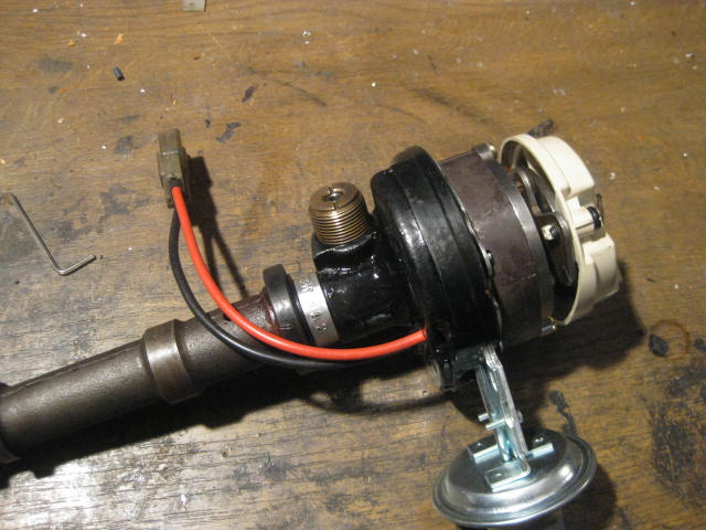

This is what an original TI distributor looks like.
Despite the wires and vacuum canister, I had to replace them.
The points distri looks similar regarding the housing.
