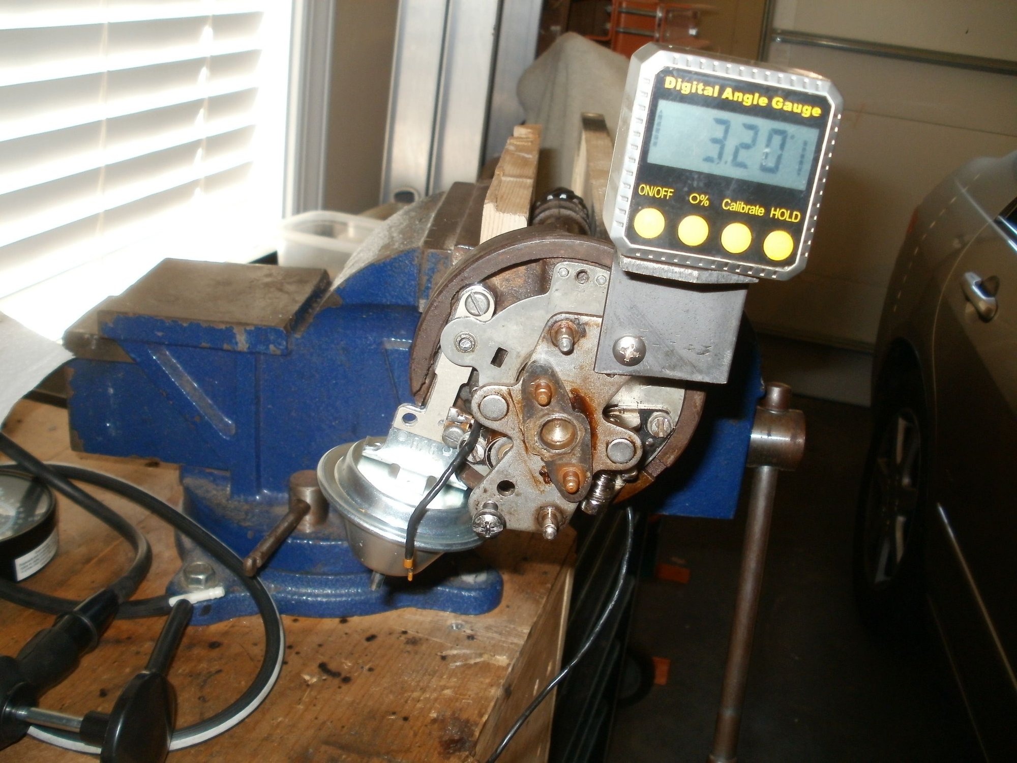

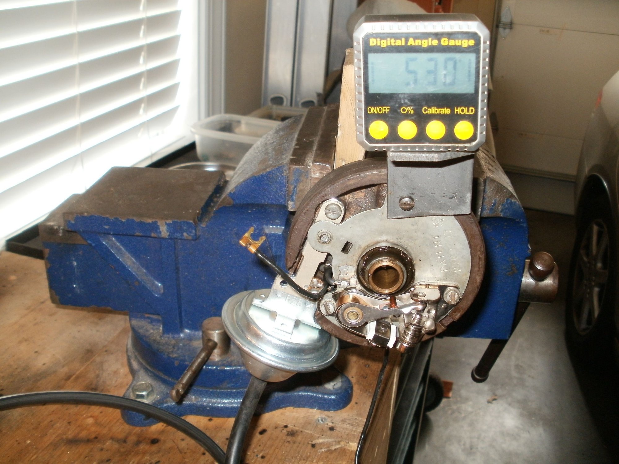

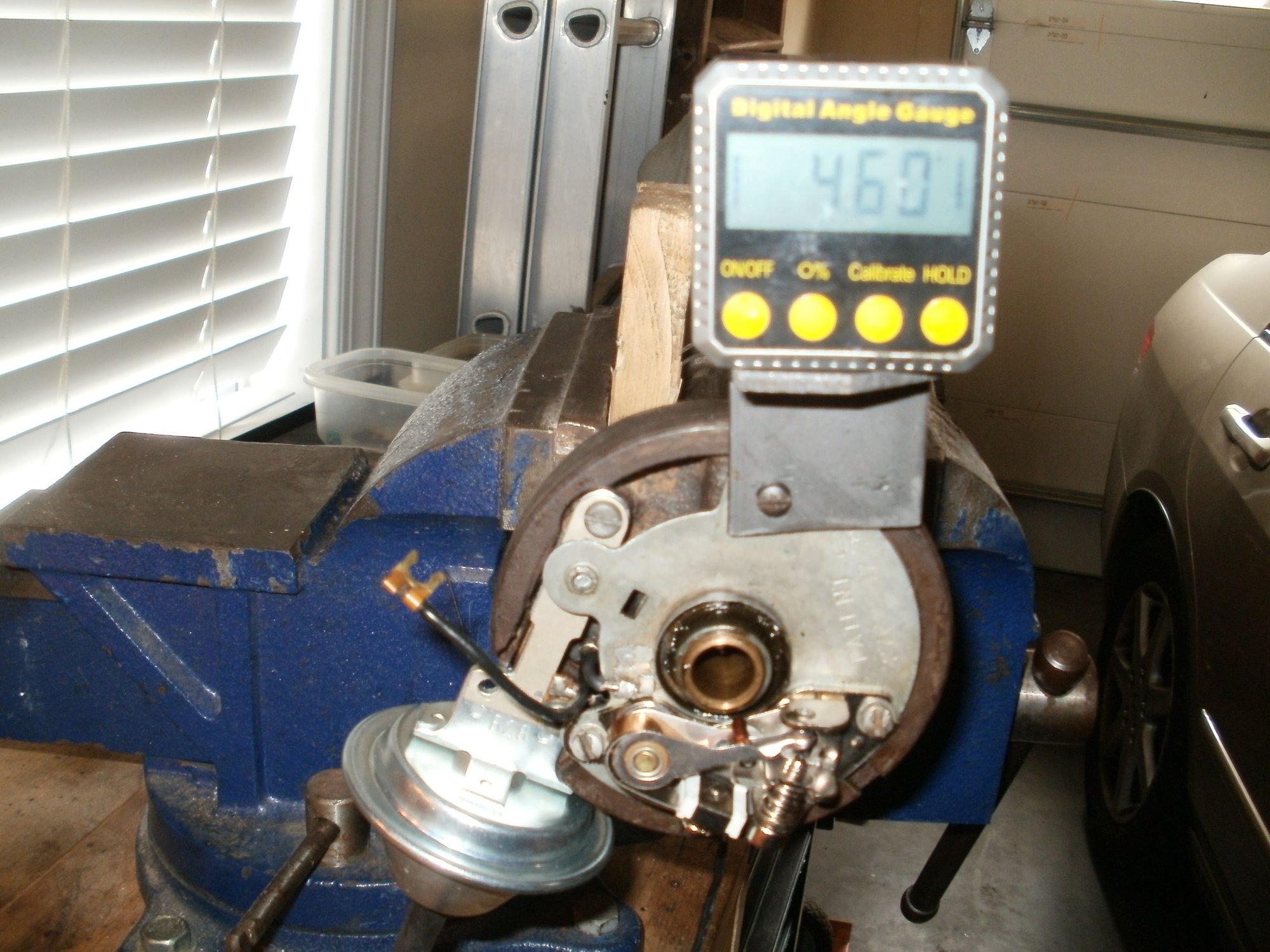

I installed the vacuum advance limiter that Lars supplied (which, by the way is an excellent piece), and measured the advance with my Bubba style Sun Distributor machine. Vacuum advance is 5.5* and centrifugal is 8.6*. That will give me 28+* at the crank.

That's an incredible piece of Bubba-Engineering! I'm impressed!! The numbers look like they're dead-on, and the 5.5-degree (11 crankshaft degrees) of vacuum advance is perfect - it's the exact design limitation of the Vacuum Advance Corrector, so your measured numbers look accurate and good. Good job with the checking and setup!
