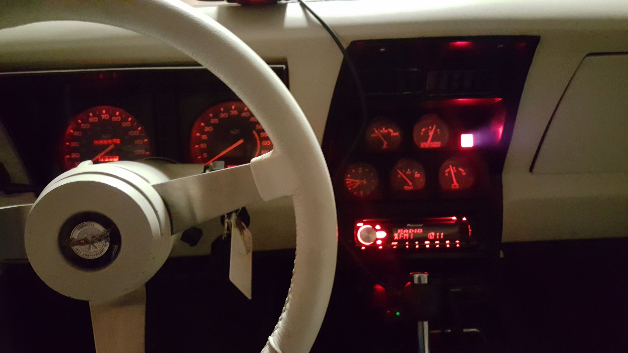

I wrapped rgb led strips around the inside of the housings for the speedo and tach, then used a little spray glue and aluminum foil on the backside of the faceplate to brighten them up a little. For the center cluster, I just used red led bulbs in the oem sockets.

Can't find a picture with the center gauges for some reason but here is the speedo/tach.
