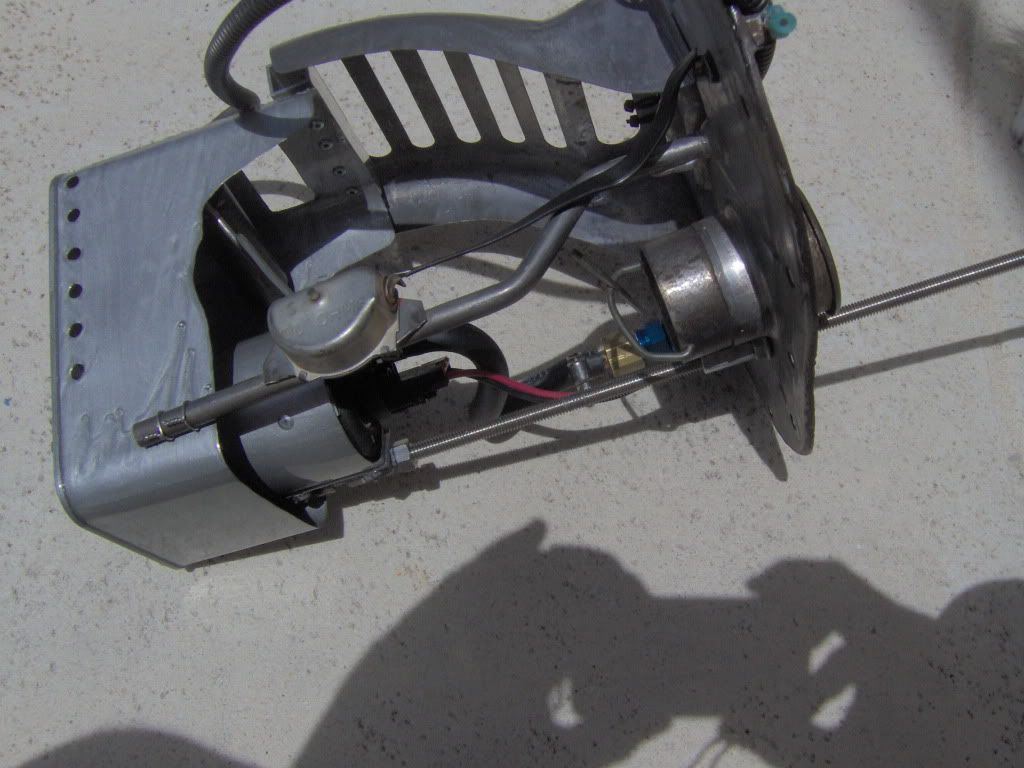

This fella came up with a clever DIY solution:
See this thread:
https://www.corvetteforum.com/forums...a-75-to77.html

75 thru 77 tanks are interchangable. 78 theu 82 are interchangable. Parts from the two series will NOT interchange.
I did the pump mod in the above picture/write-up for my TPI conversion. There is nothing that I have found, before or since, that allows installation in a stock tank without putting additional holes in the tank. The easy way, if your friend has the money and no fabrication skills is to buy a complete tank from Rock Valley - but you're talking somewhere north of $1500.
Thank you very much. You and I are of like minds because I would totally build something like that where I buy more things from a hardware store than a parts catalog. I'll pass that along and keep looking. I imagine the end result will be him paying a fab shop with more time to build his drop in pickup.
