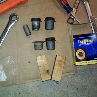

Moog, I went to Advanced Auto and they gave me a special price. The kit I got from a low price kit vendor lasted 8K miles, the original rubber lasted 90K. Moog and forget about doing it again because you wanted to save 20 bucks.
The Moog is on the right.
