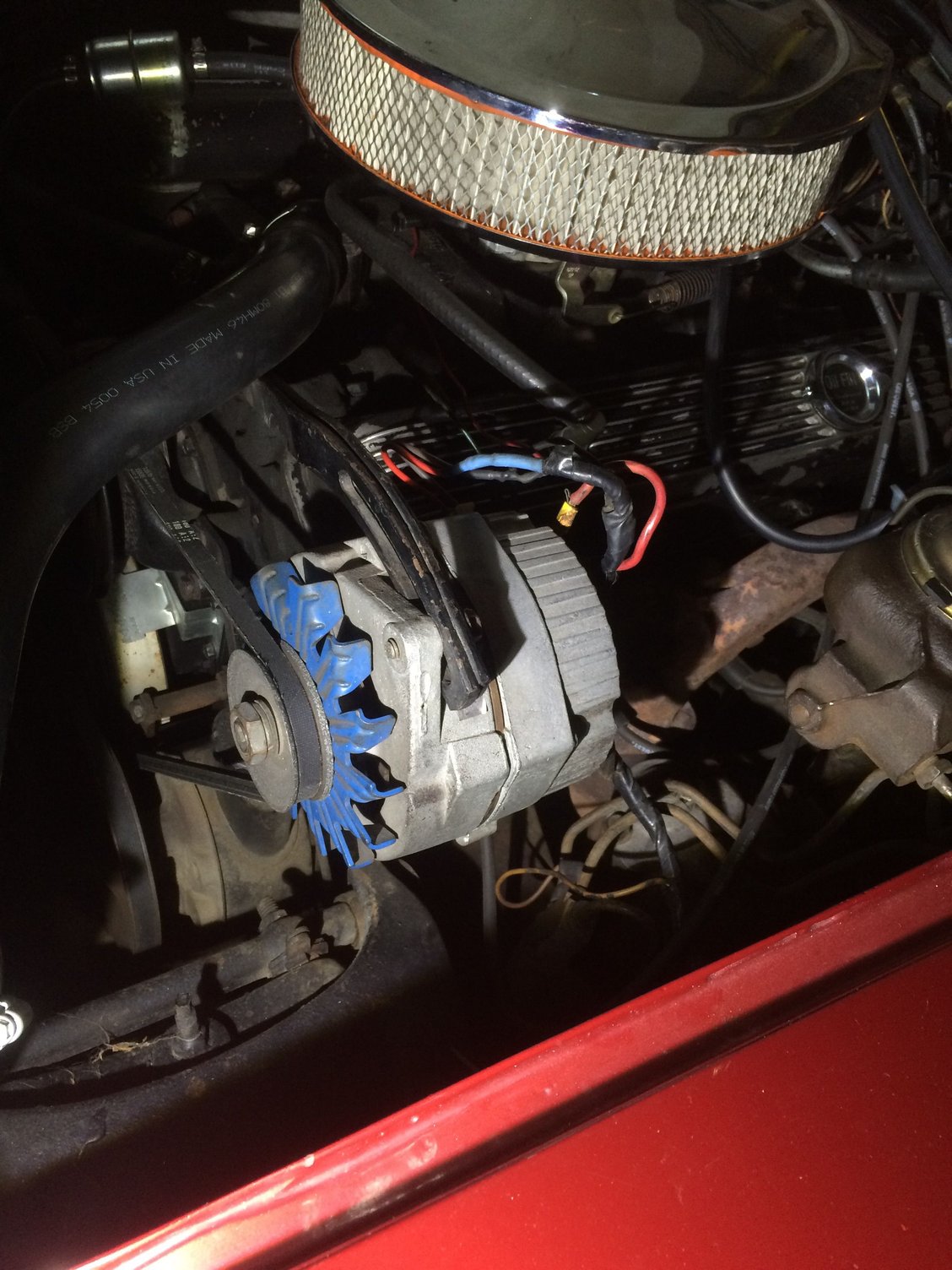

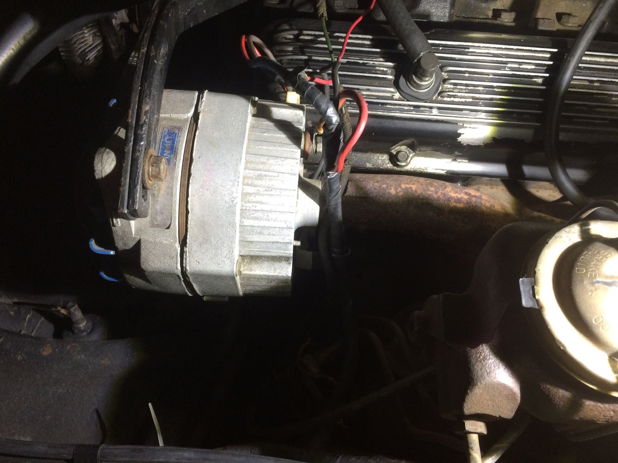

Here are the photos of the existing alternator. I assume that it isn't worth anything, but let me know.

Doesn't look like an original factory installed '69 small block alternator. It looks like a rebuild from a parts store.
