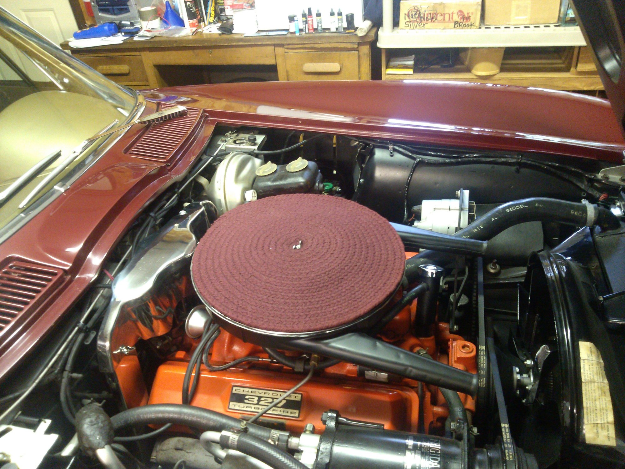

I bring my Corvette for 2 years without hood insulation and never had a problem. today I went toy car show and left the hood open for about 4 hours indirect sunlight when I shut the hood I walked around the car and noticed a line above the distributor shielding where the paint was blistering. anyone else run into the same problem

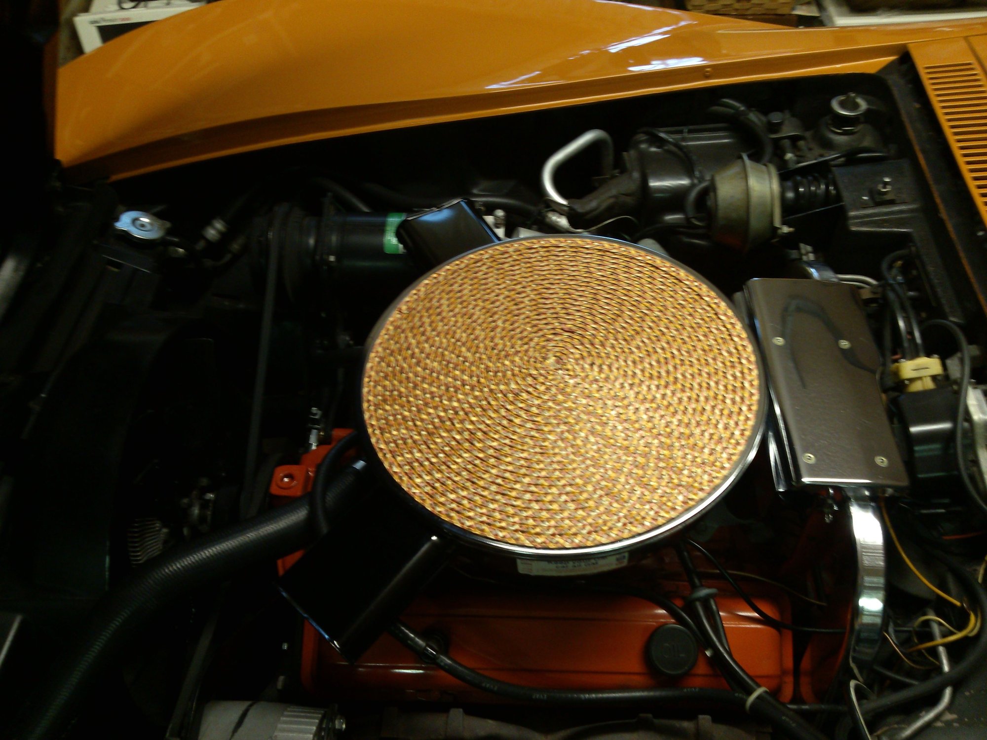

If you've got a chrome top on your breather, the sun will focus a spot and burn a line of blisters across the hood on the outside. Look at my thread from last year in C2 on my 65. Cost over $3,000 to get it all back right. I now use a 15" place mat I bought at Big Lots when I leave the hood up. I bought a woven straw one at Dollar Tree (for $!) for my 72. Here are a couple of pictures. And here's a link to my event. Don't let anyone tell you it doesn't happen. Cover your breather.
https://www.corvetteforum.com/forums...ling-hood.html

I doubt seriously the ignition shielding did it. It's curved the opposite way it needs to be to focus the sun to a point. The large dip around the outside of the chrome breather works like a mirror and focuses the beam to a spot. Then as the sun moves, it moves across the hood and burns a streak. I did a study with the breather top in the sun in my driveway and tried covering the indentation where the hold down nut goes, and that didn't do it. It was the large ring just near the outer edge. Here's a picture of what reflected on a building 8 feet away, so imagine it 3 feet from your hood. You can trust me or learn the hard way. Cover the chrome breather top or leave the hood closed. I considered painting the breather top black, but can't make myself do it yet.

it might not matter too much (well kinda because intensity of light is equal to power over area), but you guys should realize his aircleaner top is like a little 8in one, I wouldn't doubt the air cleaner can do it but what are the chances the line of the burn is exactly on top of the edge of the distributor cover and runs parallel with that cover, to me that's just too many of assumtions, the cover getting really hot and burning the paint from beneath makes more sense to me, but that's just my opinon

Unless his motor is positioned farther forward than mine, that streak is forward of the ignition cover. And it's at a slight angle. And if that caused the problem, why don't all the others do it.
OP, test it out. Pull the breather cover set it out in the sun like I did in my picture of the reflection on the building. You'll see how it focuses the beam and moves with the sun movement.

It's not a common occurence, but it does happen...and it is due to the concave ring around the chrome air cleaner cover on some models. If you don't believe it, take a bright LED flashlight and aim it at the air cleaner cover. Move the flashlight around, shining it in that trough until you get a reflection onto the hood. You'll get the picture.
Just putting a heavy cloth on top of the air cleaner will prevent that from having any possibility of happening.
