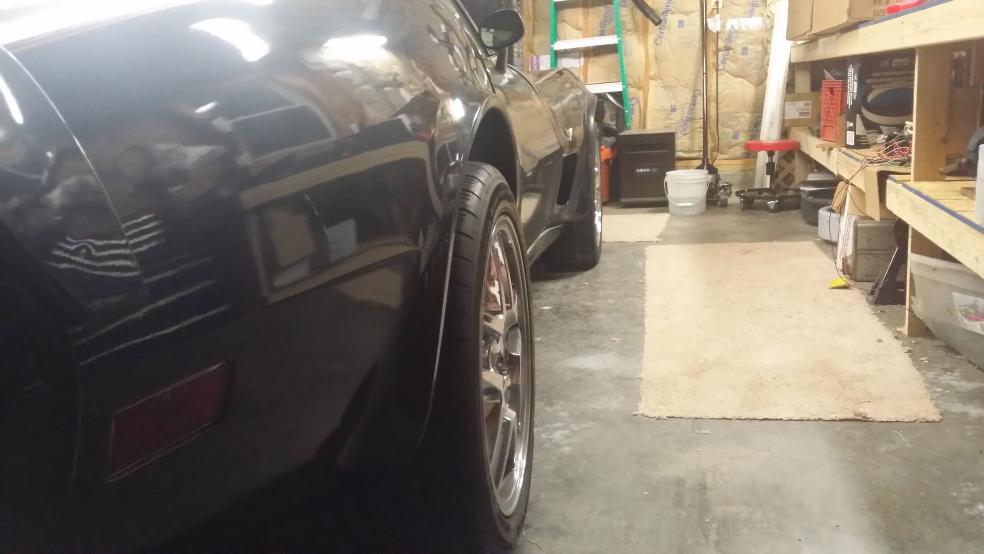

18x9 C5 Zo6 knock offs on my 79 with spacers I didnt have to move the ebrake cable, stock style trailing arms rear sway bar wasn't connected before the swap and have heard from guys that auto cross/road race these cars a rear sway bar isn't needed.
