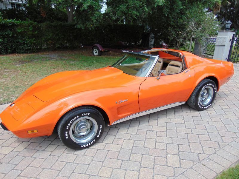

Nice 74. I'm also a Dewitt Fan.

I had very good results installing the DeWitt radiator. Still in the process of connecting the electric fans. DeWitt installed the temp sensor in the L tank under the upper radiator hose. I also ordered the new rubber saddles, and a seal,might as well. My 73 was orange, think I will go with that color. Yours looks sharp!
