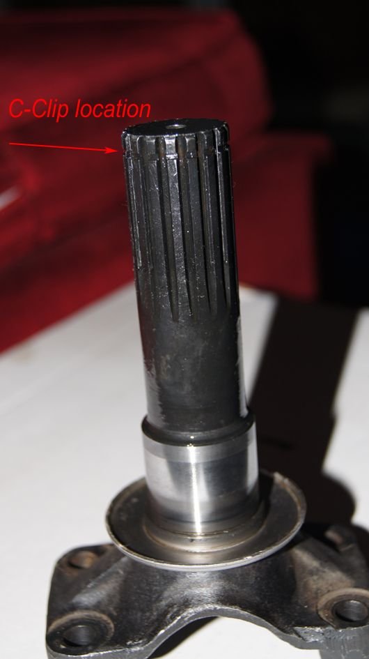

Where the half shafts removed when you did this test. If not then you may have another thing to look at.
The stub yokes in the differential should only move in and out .003 - .008" when new. As the yoke tip's wear you get more movement in and out. Once you get enough wear there is a c-clip on the end of the yoke that will fall off allowing the yoke to come out freely.
To check the yoke play you need to remove the half shalf. But I would guess they are worn more than you would like. If you can move the tire 2" then the yokes must also move in and out.
Here is a picture of a new yoke. I have marked where the C-Clip is installed. The end of the yoke past this c-clip is the tip that wears. Once its worn down enough the c-clip can fall off.

where did you come up with 0.003/ 0.008 as normal movement? I just went through my rear gears with new shafts and 0.004 wear on the center pin and I measured 0.024 movement on one side and 0.031 on the other. just curious, I have never seen a spec like this.
