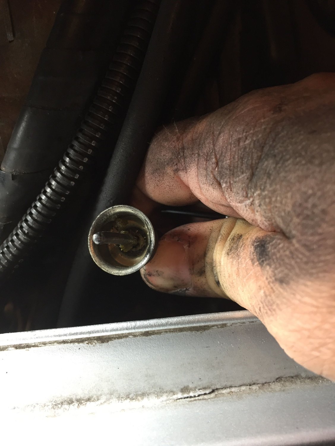

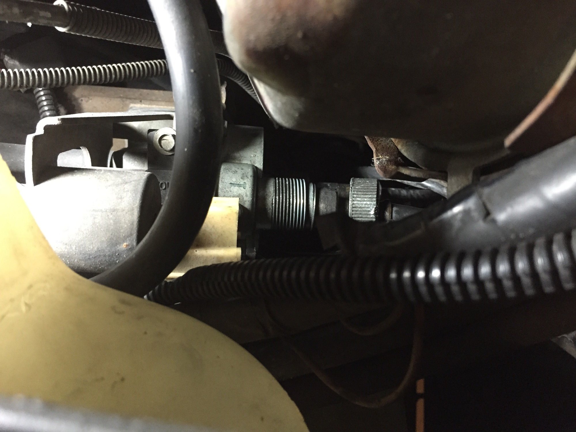

From: Central Pennsyltucky PA
Yep-upper cable spins the needle (although the collar was frozen and there's no space for a wrench between the power booster and the washer fluid reservoir or to get my damned hands in there, so it was a bitch to get it off.
Not a bad idea to use one cable-I'd never use cruise control anyway.
