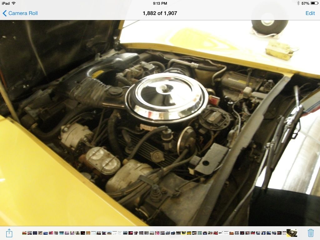

Here is a picture of the engine. I hope that will help. Please let me know if you see anything missing. It looks stock to me but what do I know. To me it seems that the previous owner just wanted to find a cheap way to get 15 more horses out of the car.

The engine looks stock to me. There is an oxygen sensor in the exhaust but its before the converter. You'll need all emission components to pass smog. Also has a check engine light that cant be lit. I see the smog pump which is good, just get a belt. I put a free flow converter on mine and it passes just fine.

On the sticker it will state CA or Federal. The Smog guy will follow what the car was built with using the sticker.
You will need a CARB approved cat. It does look stock though.

It also appears to have a non-factory exhaust in the back, if it is cat-back capable no issue.
