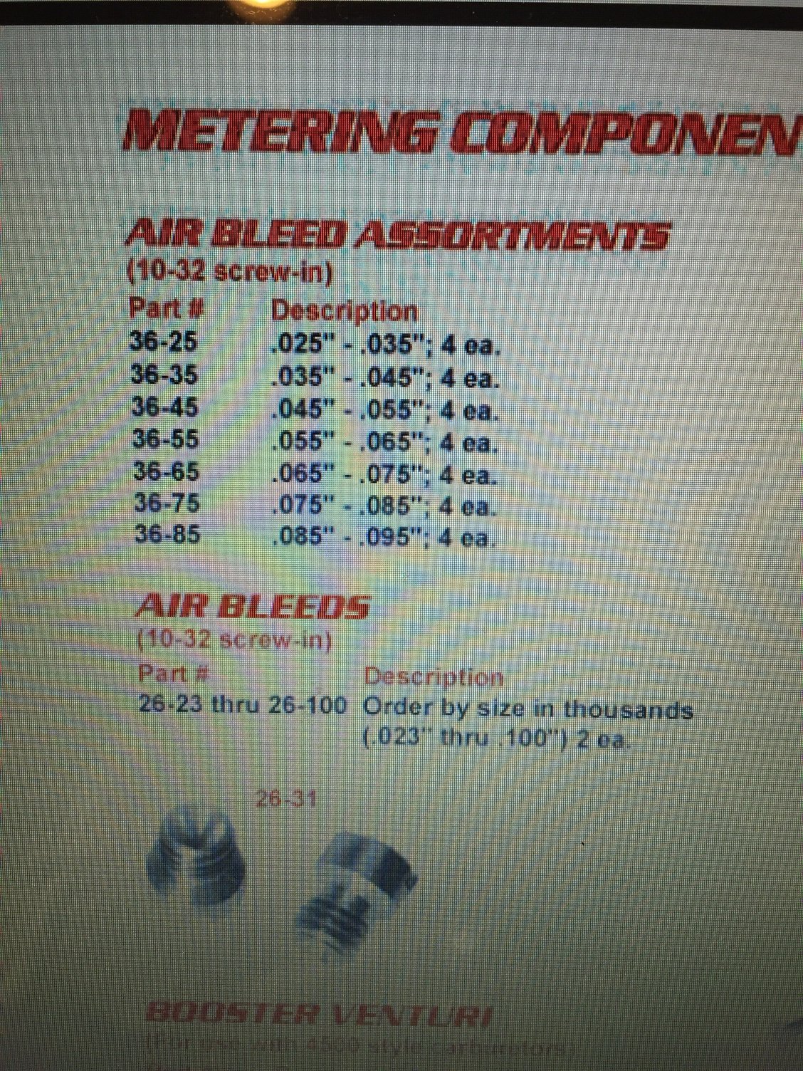

Figured out my idle mixture screw(s) adjustment. The car surged at cruise speed on the highway, no surge on acceleration, no popping on rapid deceleration. Raised the floats a 1/8" turn, no change. Opened up the mixture screw adjustment 1/2 then 1/4 then 1/8 turn, then back to 1/4" and that seems to have taken care of the surging issue. It idles nice, but rich. Sometimes its hard to start. Exhaust smells of what I think is unburnt fuel. An Email to QFT and they say to "swap out the idle air bleeds for two sizes bigger". In my mind this will allow more air into the idle circuit and lean out (more air:same amount of fuel) and hopefully get rid of the "raw fuel" smell. Correct?
For example: if the current air bleeds are ".025-.035" then two sizes higher (larger) would be ".045-.055", right? (see pic above, sorry its so large), OR do I go from .025 to .027? (im just using those numbers for size reference, I have no idea whats in the carb now, but is listed on the tech page that came with the carb, Ill just double check it before I order the right sized air bleed screws (ha, look at me using the terminology ).
Then, unrelated to the above, I was thinking to improve the fuel mileage (or at least attempt to) perhaps I should adjust the secondary linkage to "super progressive" (if its not already). The last few tanks of fuel were in the 8.5 MPG to 10.5 MPG area. Was hoping to get to 15-18 or so. No idea if that obtainable or not with my cars configuration.
Is my theory flawed somewhere, or am I on the right track?

Keep in mind my limited automotive carb terminology and how the different functions affect and relate to other items.
I have no idea how many turns out they are. They're out not quite a half turn from the "out of the box" position. If I run them in anymore it "hesitates" at speed on the highway, which is 90% of my driving.
I have no idea how (or ever heard of) adjusting the secondary blades. Is this what I was referring to above, the "60% - 40% - 1-1" settings?
It was suggested by QFT to "go up on the idle air bleeds two numbers".
Papers from QFT show "71"'s in the carb now. Is that .071? no idea. So I'd move to 73's, or .073? Waiting on QFT to confirm to me.
dodosmike

Trying to find a local source for air bleeds is proving difficult.
I have 71's now. Looking for 73's as well.
Secondary linkage is set on medium now. Just need to find a black rod for the super progressive hook up.
No vac leaks.
Transfer slots looks correct comparing it to the pic below.
Dodosmike
Best source for sized air bleeds is Bo Laws Performance (BLP.com). Or, you can buy blanks and Summit etc. and a pin drill set and drill your own.
Pass. Blp want $31 to ship them to me.
$8 for the bleeds.
I'll continue looking locally.
Dodosmike
