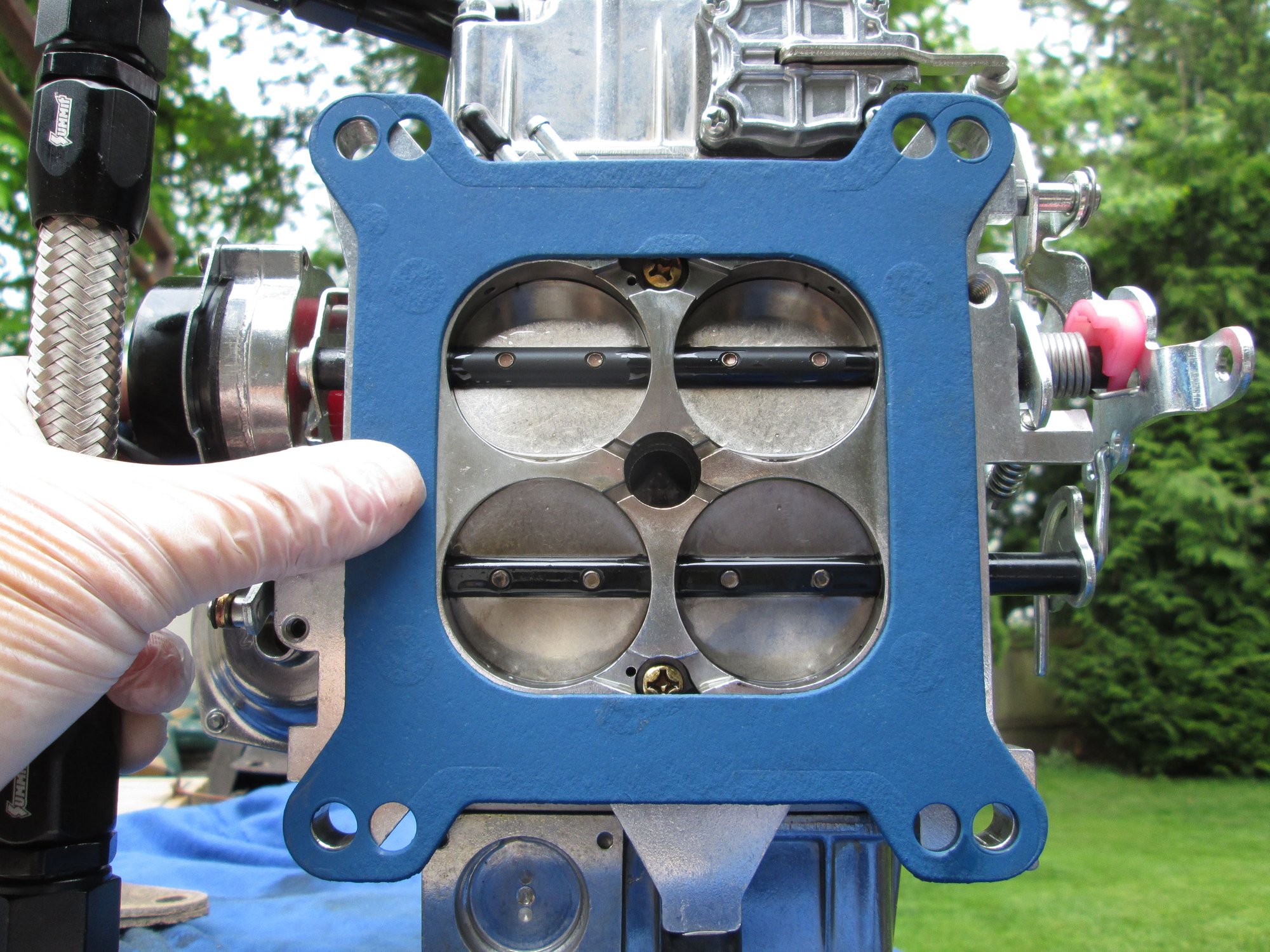

Transfer slots show minimally.

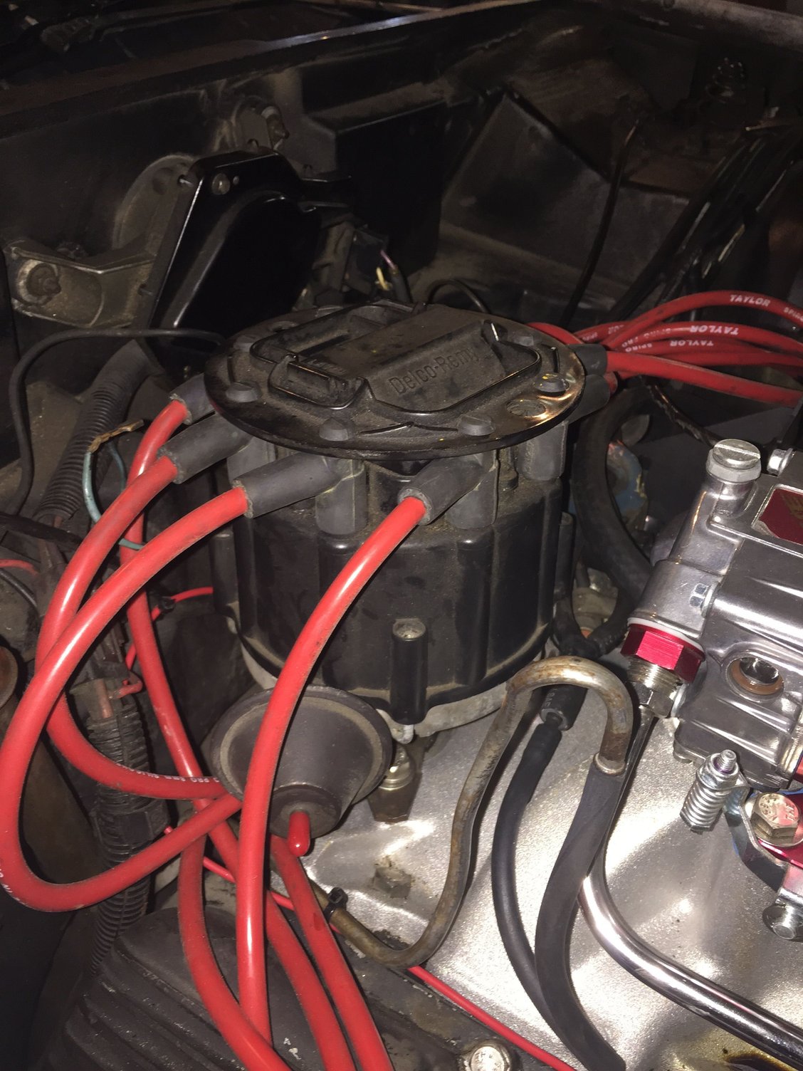

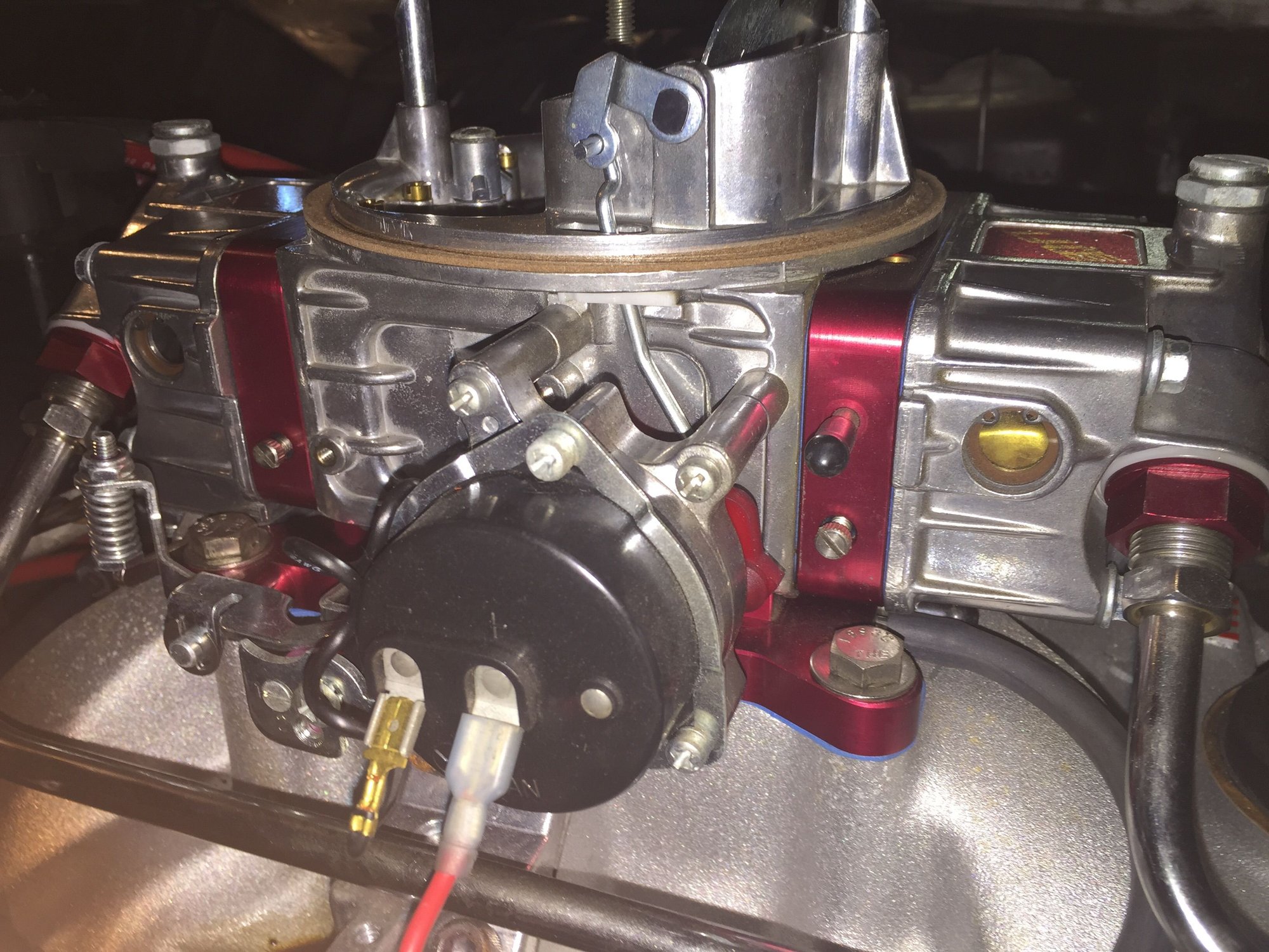

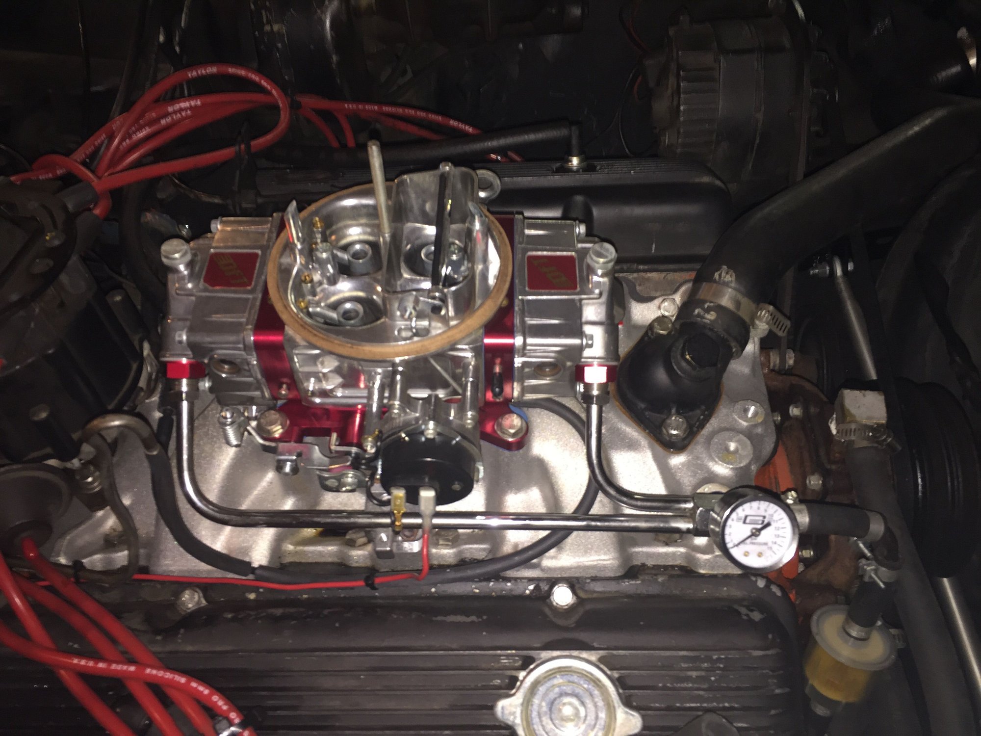

In the base of the carb the larger hose goes into a T then to the drivers side valve cover and also meanders around to the power brake booster.
Smaller hose comes out of the carb base, pass side front, then runs down into the can under the washer bottle.
The distributor vac port is blocked off. As is the port on the side of the carb near the top.
Sorry for the big pics. Don't know how to make them smaller off my phone
Look and sound like its hooked upright?
Dodosmike

OK I do see a couple things, the vacuum can on the HEI distributor is capped off with a red plug. Get a fresh piece of hose that fits snugly and test the can first. To test, suck the air out. This will pull the advance plate inside the HEI. Hold the hose shut with your tongue to see if it's holding vacuum. When you release your tongue you should hear the advance plate in the distributor snap back to its original position. If it leaks get a new vacuum can. You definitely want that vacuum advance hooked up if you drive on the street.
Now refer to the QF instruction sheet I sent yesterday so you can see both the timed (right front corner) and full vacuum (right front inboard)
ports under the base of the carb. Or look at it in my photo.
The correct vacuum port to connect the HEI vacuum advance can is visible in your photo number two, also capped off with a black plug. Its right next to the hose that is already being used for something else. Use needle nose pliers to remove the black plug and connect the hose to the distributor there. It's hard to see under the carb there but make an effort to be sure the hose is snug and not loose. If it fits the HEI vacuum can nipple snugly, it will also fit the vacuum port.
The only other thing that seemed odd were the float windows. I can't tell if they're over full, or empty. The correct float level will show gas halfway up the windows while idling. If that's not what you see, then refer to the instructions link and adjust the nut on top of the float bowls until you get it right.
Once you check these two things, let me know how it runs.
Steve

Hey Mike, one more thing. You mentioned the power brake booster is tee'd in with the PCV valve. That's the large line in the back of the carb that goes to the valve cover. The PCV keeps the air inside your crankcase clean by continually sucking it out to the carb where it gets mixed with the fuel/air mixture and burned in the cylinders.
The brake booster needs constant full vacuum to work best and should not be tee'd into the PCV because the PCV is a constant flow line, not meant to operate vacuum devices like the brakes.
Edelbrocks way of punishing Holley carb owners is to drill the manifold vacuum utility port right below the back of your carb. To properly use this port for your brake booster you can either 1) Buy an Edelbrock carb...not! 2) Find a low profile vacuum fitting which Edelbrock used to sell. I could not find it on their website today. Or do what I did 3) use the lowest profile fitting you can find along with a double carb gasket or thick gasket, and grind a small recess in the rear carb flange to make it all fit.
