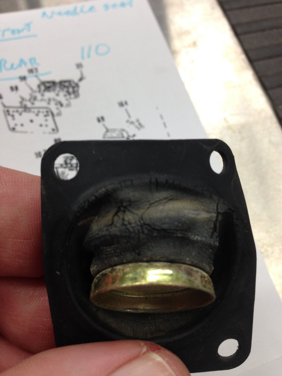

Dont know if you have points or hei or what kind of carb? You could be rich due to missing or too much fuel. Is the popping from the exhaust or carb?
Basic test can be done with a timing light ... just attach the pickup lead to each plug wire while running and make sure the light is rhythmically flashing when attached to each wire.
I like to use straight pins inserted into the boot of the plug wire at the cap and then use a meter lead to jumper the carb stud to the individual pins in each plug wire to see if the problem gets worse or stays the same. If it stays the same you have the plug in question. (DO NOT just unplug spark plug wires... you can cause cross firing in your cap and ruin it you always want to ground out the arc to ground.)
If everything is firing correctly then it sounds like a hung / stuck float or if its a holley a bad power valve / hng float / hng or dirty needle and seat. My holley rubber products suffered a major deterioration issue this year and my power valve and accelerator pump diaphragms were all damaged. Not sure what carb you have but I had to replace my powervalve as the car was running really fat and poping out of the exhaust.

With it running you can look down the carb and see if fuel is dripping out of the boosters. The carb sounds like its newer than the other stuff so maybe start there.
If it is you may have your fuel levels set too high in your bowls.
I dont know the avengers but I just looked them up....looks like they may have sight glasses in the bowls to check the levels on some of them.
I was not expecting to find issues in my carb as it has very little use on it... but the ethanol in all of our gas now a days seems to be having an affect on these cars that sit more as the gas will evaporate quicker with the alcohol content. My car is seldom driven as it is being put back together. My powervalve was a perforated mess. I cant see yours being bad when it so new but u never know.
good luck finding the issue.

My understanding is if you use the car often enough then it should not be an issue. The problem is for cars that sit long enough for the fuel to evaporate faster due to the alcohol content . I didn't make it up. This came from edelbrock tech (my fuel pump). I don't have a pic of my fuel pump diaphragm, wish I could show u those. But below is my powervalve with a completely eaten away diaphragm and my accelerator pump which was cracked to no end. Two different companies holley and edelbrock. You tell me.
Anyway NOT saying this is his issue especially since his carb is so new just saying it can happen. His condition sounds like a hung float or blown or broken powervalve.

Just went through the same problem with my 69. stock original quadrajet and point ignition, so car is a little different, however it was running great first few trips of this cruising season, then last week started missing and backfiring just a few blocks from home. To make a long story short. The condensor was bad and the points were burnt. So lightly burnt that you had to take them out and get them under bright light and then they just looked dull. Replaced them and the condensor and all is well. That set of points and condensor had maybe 200 miles on them and they failed. The were bwd brand from orielly auto and this is the second set I have had fail. Am going back to Echlin points from NAPA That is what I used years ago and always had great luck with them. I now carry a spare set of points with me and enough tools to swap them on the spot when they fail. I also carry a jumper wire with a ballast resistor to supply battery to the coil in case the resistor ignition power wire fails (which is common on early c3's with point ignition).
